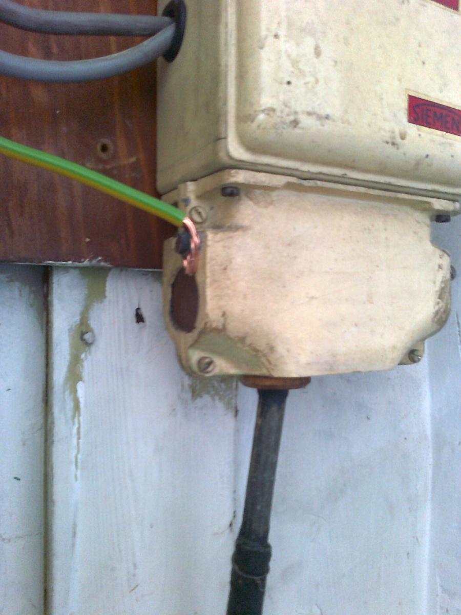

Is it ok for you to connect to it ? earth clamp to sheath.
I had a call tonight and a customer could not reset his RCD so no power at all.Ok fixed the fault unlpugged the kettle and it reset as soon as we plug it in it tripped so power all restored.Bid disadvantage of having 1 RCD for whole house.
Double checked earth loop and got over 8.2 ohms on 32amp ring main and thought it could be a loose connection so did cooker socket and got 7.92 for a 40 amp MCB.
Nice bit of 10mm cable on gas and water but no EARTH at meter head,no MET nothing.Had board changed about 10 years ago he said.
All the houses roughly the same in the street all built same time so popped next door and they had a TN-S.Soldered to a wide strip of woven braided steel strap.
So fitted a clamp on cable sheath ,16mm to a MET and 16mm to CU and gas and water connected ,rechecked and got 0.62 ohms on ring so happier now.
I am amazed that it had no earth at all and had been like it for years.It has even had a new digital meter fitted and you would have thought that the meter fitter might have noticed.
No cup of coffee as kettle knackered but £10 tip for coming out.
Should i inform DNO ?
Yes you should inform the DNO, although whether it will achieve anything is anyone's guess.
What type of clamp did you fit, it should have been a constant tension spring clamp.
Oh no it was a Legrand Tenby rapid clamp ultra

It done up with a screwdriver not a socket wrench ! if i put my adjustable on my screwdriver i might be able to crush it if i really tried.Its that same as a band type ,the screw does not touch the shroud it presses on a band.Its only lead so you have to be careful.

EARTHING CLAMPS MUST NOT BE USED ON PAPER INSULATED/LEAD SHEATHED OR STEEL ARMOURED CABLES

Well all I can say is you are fools all of you for even considering making a connection to a DNO cable of any sort as it is a CRIMINAL OFFENCE under STATUTE LAW.
That is you will be prosecuted by the Crown Prosecution Service, HSE may also want a pop as may well the Police and the DNO may well also undertake a Civil Law Prosecution.
In an emergency situation all you can do is TT.
You should have placed an emergency safety call out on the DNO and forced them into maintaining their network according to the requirements of Statute Law.
My local DNO will not fit or remove 951's as it is considered dangerous unless they do a live disconnection to the incoming cable and then remove the clamp.
These devices are NOT designed to connect to a "soft" cable of any sort.
If you have fitted the clamp I think you have, I have not looked this up, then this is even worse.
I am appalled by your lack of knowledge about the Statute Law that you are legally bound to work to.
Oh and as fat as sweating a joint on, same goes, it is a CRIMINAL OFFENCE.
