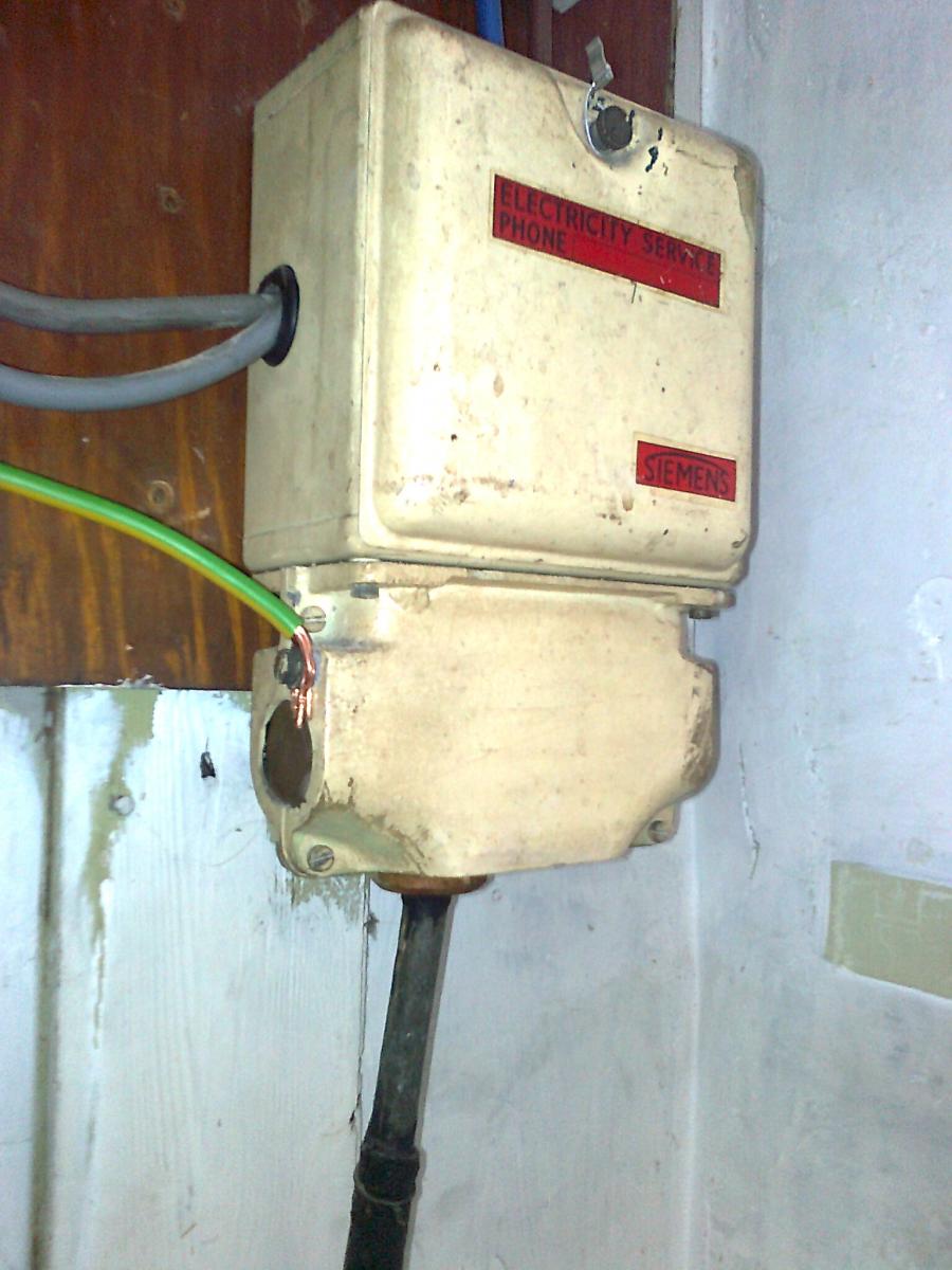

I had a call tonight and a customer could not reset his RCD so no power at all.Ok fixed the fault unlpugged the kettle and it reset as soon as we plug it in it tripped so power all restored.Bid disadvantage of having 1 RCD for whole house.
Double checked earth loop and got over 8.2 ohms on 32amp ring main and thought it could be a loose connection so did cooker socket and got 7.92 for a 40 amp MCB.
Nice bit of 10mm cable on gas and water but no EARTH at meter head,no MET nothing.Had board changed about 10 years ago he said.
All the houses roughly the same in the street all built same time so popped next door and they had a TN-S.Soldered to a wide strip of woven braided steel strap.
So fitted a clamp on cable sheath ,16mm to a MET and 16mm to CU and gas and water connected ,rechecked and got 0.62 ohms on ring so happier now.
I am amazed that it had no earth at all and had been like it for years.It has even had a new digital meter fitted and you would have thought that the meter fitter might have noticed.
No cup of coffee as kettle knackered but £10 tip for coming out.
Should i inform DNO ?

That looks like an old metal cut out.
The DNO in my area (NEDL) are changing one of these at one of my customer's houses as they are no longer permitted & they have to change them free of charge to the customer.
They have to dig a hole outside the house & chop the cable to isolate the metal cut out, fit a new plastec one then reconnect the cable & make good the hole.
This gets just gets better! So some poor jointer has to climb in a wet muddy hole and split a live paper lead! Breaking through the lead is when things are liable to go wrong. The jointer has to wait for the numpty to change the head, then he has to make a joint, which includes clamps or plumbing on to the lead. To add to jointers misery it’ll probably start raining.

I had this problem in my house. BS951 on the TN-S sheaf. Rang up EON, who said they wouldn't touch it, but they could come and make it PME for £360.
Spoke to a few other sparkies who mostly said keep trying, and they will eventually send somebody round to put the correct earth clamp on. It never worked, I tried 3 times, got put through to various departments, and was eventually told they have no duty to maintain the earth clamp to the customer. This was wrong, but for different reasons.
I didnt believe them, and after some research, found it was true, in a roundabout way.

Biggest advice I can give to anyone is be persistant with the dno, they kept on giving me different numbers and fobbing me off. In the end when I spoke to a new lady I said "this is a very dangerous situation and needs to be sorted!!!!! oh by the way what is your name?" then to my surprise she said I will put a call out for you ref no......
with in half an hour nice old bloke turns up & bobs your uncle. He did say that they are not obliged to make a connection and could quite rightly charge me for a pme upgrade but as I got a good reading off the sheath he made my day.
I'm now going to earth the metal service head aswell.
