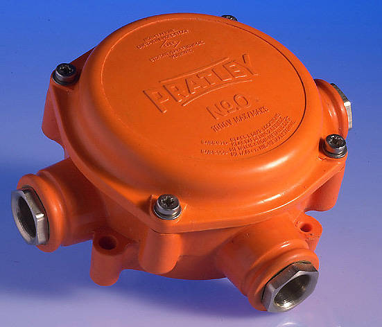

TLC have Pratley underground junction boxes that are made of metal and you can screw a SWA gland straight into it. I used some 4/5 years ago that where buried in a garden, I had to open one up a few weeks ago to alter the type of light. When I opened it up, it was clean, dry and looked as good as the day I first did it.

So there are basically three types of waterproof joint boxes, the Pratleys as shown above, the resin sealed boxes and those little waterproof plastic joint connectors used in fish ponds and the like.

Pratley boxes for me or Wiska with the gel if it has to go underground!
