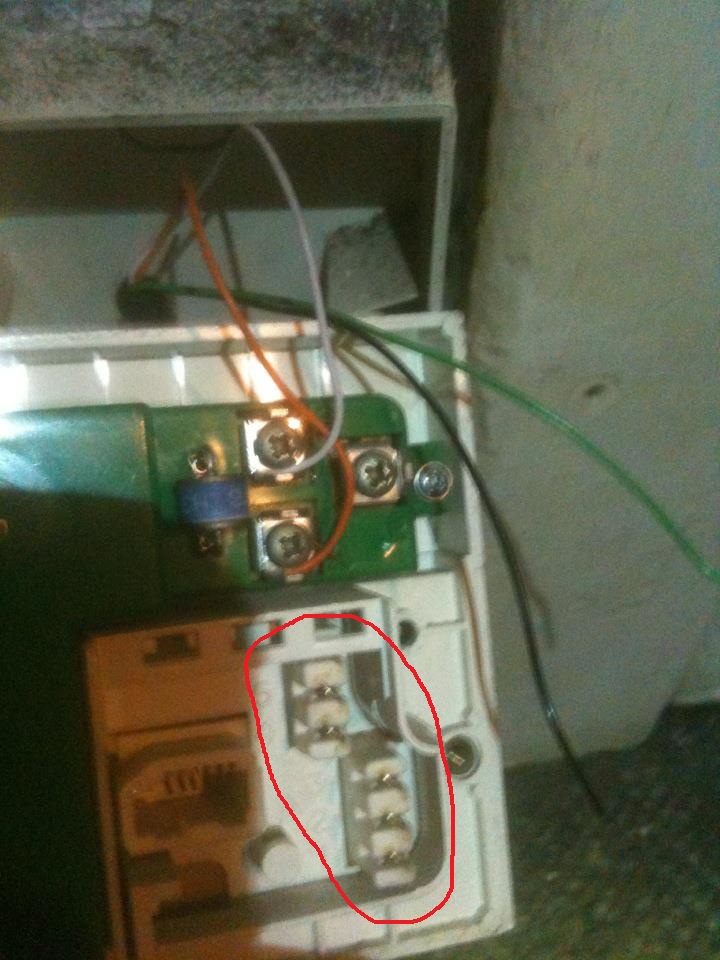

Hi all. I'm currently trying to add a socket in an upstairs room from the master socket. At the master socket there is a 4 core cable where Orange goes to A and White goes to B and green and orange are cut back. At the slave there are 6 junctions with a 4 core cable with orange, white, blue and green. I've tried every possible connection of the colours in junction 2-5 but nothing works. On a couple of them the phone will ring continuously but none have the dial tone. Any help would be much appreciated
this is the situation at the master.

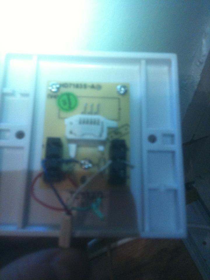

And this is the situation at the slave. I did what was suggested and the phone just continously rang again but with no dial tone. [ElectriciansForums.net] Telephone slave extension help needed[ElectriciansForums.net] Telephone slave extension help needed
ive tried taking out 3 and it still didnt work. I forgot to mention that the cable at the slave is from an extension lead coming from the master. I have cut this hoping to put it in the new socket rather than having the extension laying around, would this change what needs to be done?[ElectriciansForums.net] Telephone slave extension help needed[ElectriciansForums.net] Telephone slave extension help needed
Wow you seem to have a lot of extensions there. I am afraid the way you have done it is not going to work. If you are going to run a slave socket from a master the connections have to be done at the back of the sockets in the previously mentioned terminals 2 & 5. Also the extension cable you have used I image is stranded rather than solid core which is not ideal for punch down terminals. Hope this helps.
