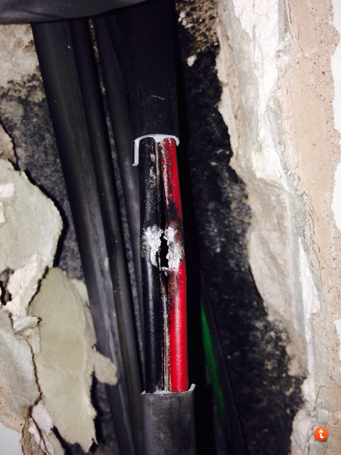

Pulled back one layer of insulation to find this. It was a live lighting circuit. Not even insulation tape around this one. Oh and the green/yellow sleeving is missing as well.

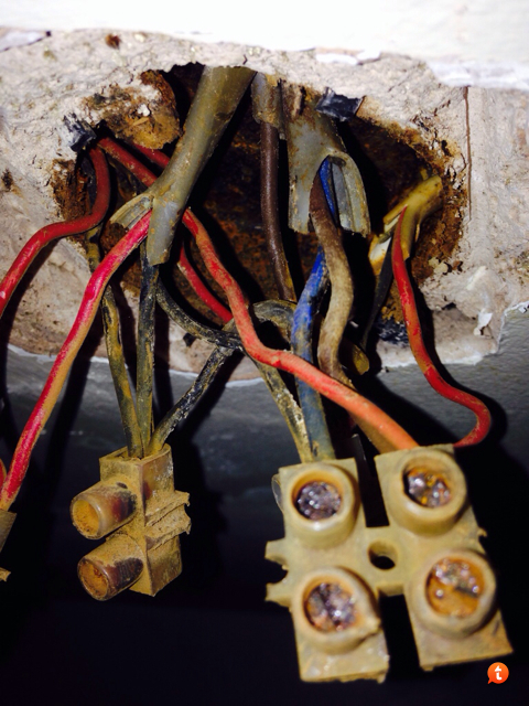

spider pulled out to repair a door bell... wooden box above a mirror cabinet ,there was a unenclosed 50watt halogen sitting in that space too, plasterboard doing for its lid... £50k renovation job, come on :-(
informed the customer, been told that shes been helped with all her money+savings by them builders. charged £30 for call out and door bell repair and left home...
