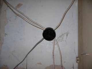

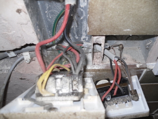

Here are some DIY faults which I found recently when I fitted a new kitchen.SAM_4019.JPGSAM_4174.JPGSAM_4185.JPG
1)Yes one of the water pipe was leaking, onto the spur from a spur from yet another spur.
2)JB behind the oven with 240v going in with T+E 1.0mm, 240v going out via flex, to each under unit light with built in Transformer.
3)Spur to a FCU using 2.5mm T+E from a 40 amp cooker circuit wired in 6mm T+E
The kitchen has been totally ripped out and renewed.
