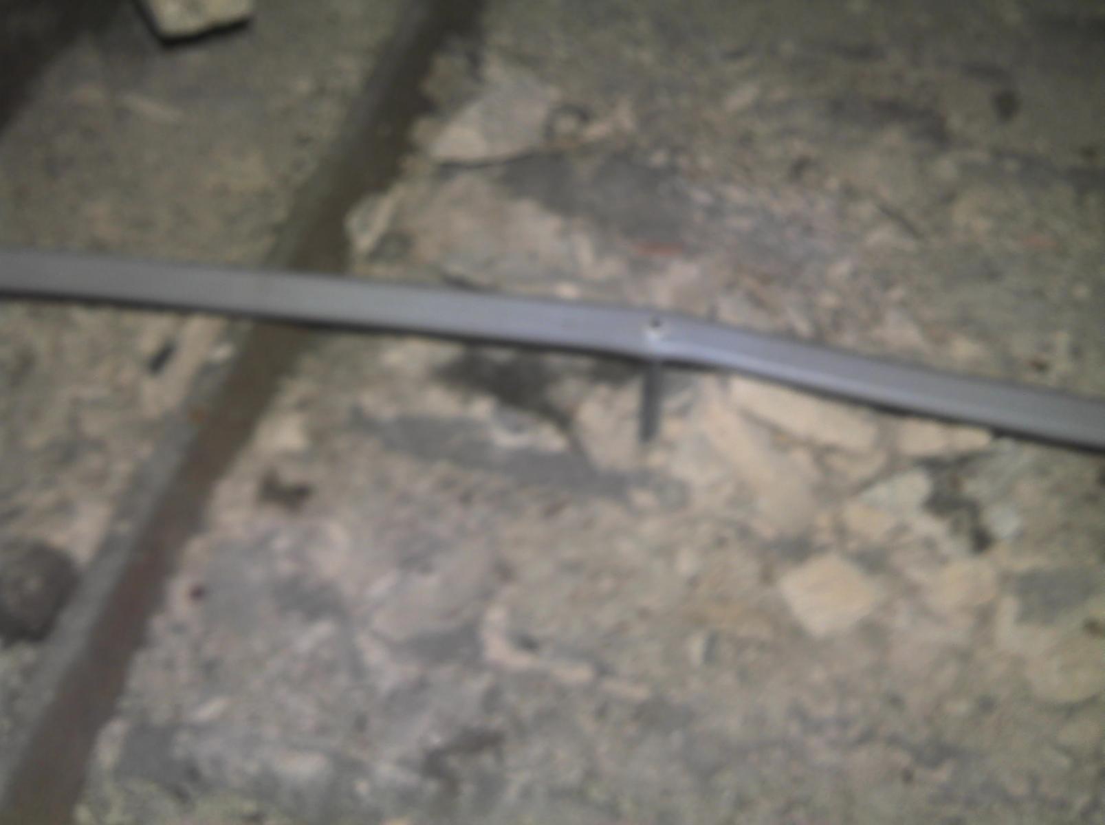

Changing a CU as part of a house referb, stripped the old board out and fitted the new board with basic circuits for work to continue, and tested the remaining circuits ready to couple up. A quick check prior to the couple up showed line-CPC fault on upstairs lighting circuit. Great! Newly plastered ceilings, walls etc boarded loft, tiled bathroom, laminate floors.
Ho hum, out with the Fluke and round I go trying to narrow it down a bit using the 'getting warmer, getting warmer, colder now' resistance test. Pinned it to the landing light being nearest (thankfully not in the walls) and went into the loft. Second board I lifted and there it was. Could have been worse I suppose :-/
