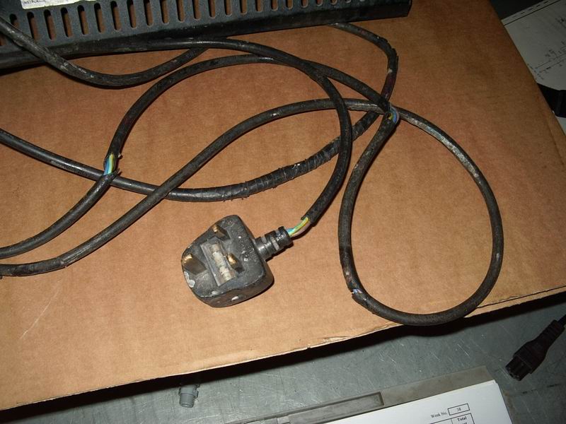

Some one bought in an infra red heater (car paint spot drier) to have the lamp replaced, I was more concerned about the lead!...
even the brass tips on the plug were worn round, I will be fitting a nice piece of blue arctic cable and a new plug before replacing the lamp.
It did have a PAT sticker, but couldn't make out the test date.
