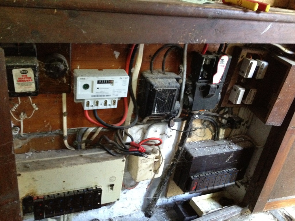

Got called out yesterday to a refurb job just about to be started in a domestic property.
Basically no power at all in the property.
After a bit of looking round and finding the supply cupboard I found this.....
After a call to the local dno
I found out the property was deemed unsafe and they pulled the fuse.
But left the fuse out with live exposed parts!! Nice.

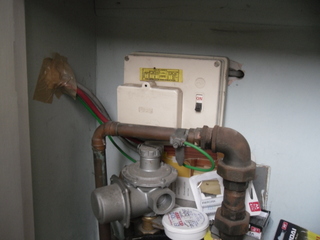

I am due to install a new split load CU, at a neighbours house. After I saw where the CU is installed, in a small cupboard in the hallway. No regs when this was installed...?????SAM_4569.JPGSAM_4570.JPG
hi dns, is there any reg that says a db must be a ceartain distance from a gas meter?
the cables probably come in through the back, so you may have too fit the new db in the same place?
