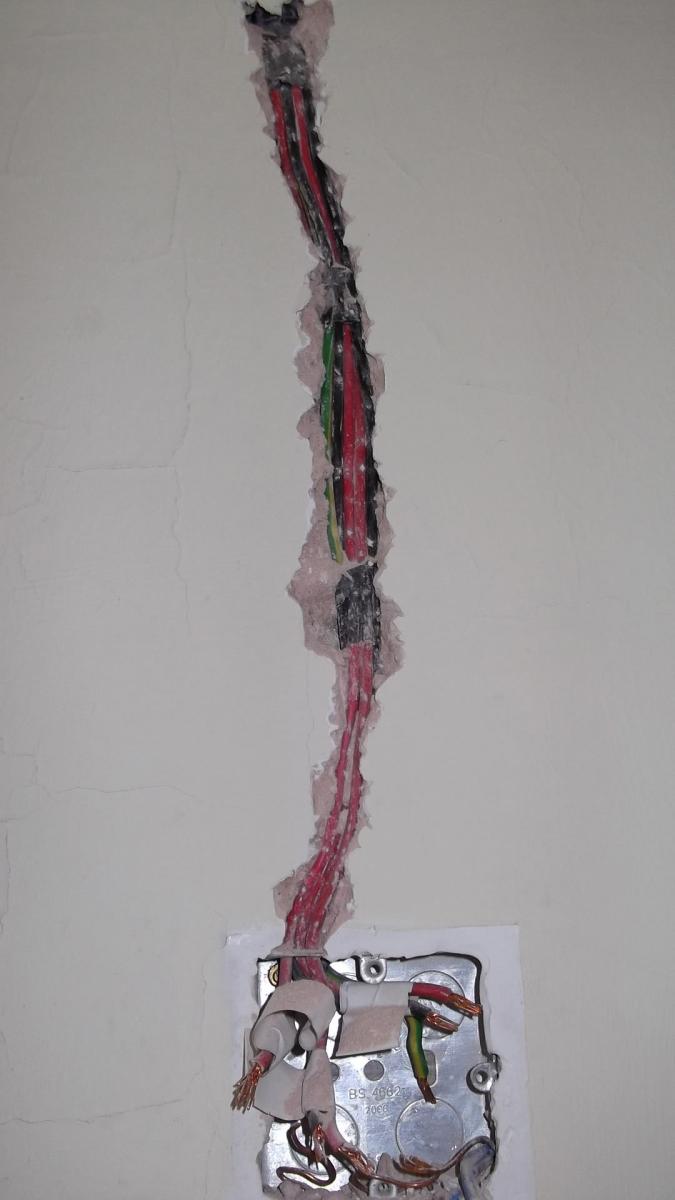

Had a good one just before Xmas.
Customer phoned stating she couldn't get hold of her usual handyman and that her wall lights weren't working.
when I arrived she informed me that a handy man had wired and install 2 new wall lights 6 months ago, he couldn't get them to work correctly they kept flickering so he advised the customer he would send an electrician, 6m later still no electrician.
On closer inspection I could find no joints for the feed or sw so I started quizzing the customer, turns out there had been a 3rd light which hadn't been required on an adjacent wall behind a large picture.
after having some fun with a hammer and chisel I found all the cables in terminals blocks and just plastered over, no box, no tape no protection at all, and to top it the nail for the large painting had missed be about 20mm

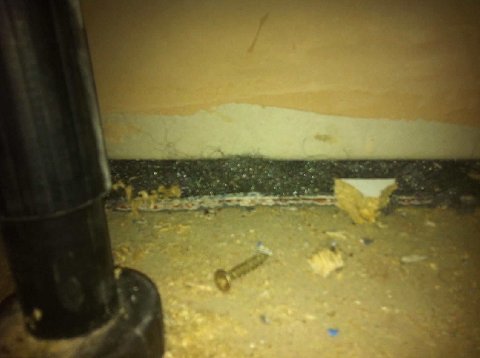

Yes its the earth thats missed its target. Not quite as dangerous as it first appeared, though, as the earths from both cables are running down one bit of sleeving, and have been beautifully twisted together all the way down, so at least there was earth continuity past this fitting. I never thought I'd be slightly pleased to see twisted together earths!
Wasn't that long ago, there wasn't any such thing as earth sleeving... Careful dressing of the bare earth conductors was the order of the day!! lol!!
