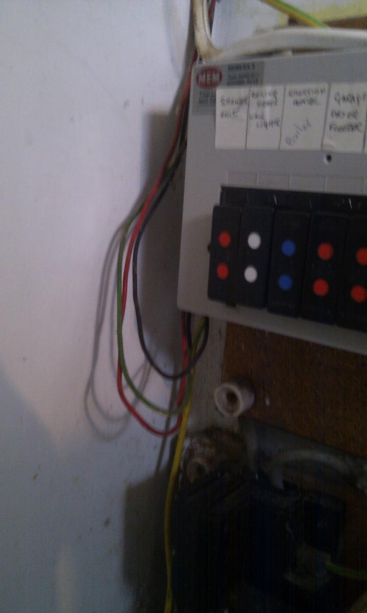

Thought I'd renew the CU and rewire the garage at myIMAG0054.jpgIMAG0055.jpgIMAG0053.jpg
parents bungalow... nice for my assessment....
Then I had a look in the loft...IMAG0056.jpgIMAG0061.jpgIMAG0059.jpgIMAG0061.jpg IMAG0058.jpg
So off to TLC tomorrow... going to need a lot more cable!

"Do you fix washing machines?"
"Yes, but it's not my preferred type of job", I said. "What's up?"
"It trips the electric every time you put it on."
They'd had a spark round, who said it was the washer, not a fault with the installation.
So I went, checked out the machine. No obvious fault.
Plugged in, switched the SFCU on above the worktop... trip.
Switched off SFCU, meggered back... flat.
Turned out the socket had moisture and dirt ingress.
Replaced the socket, cured the little leak, meggered >299
Power on, Zs 0.71, RCD tests OK.
Take a closer look at the consumer unit and WHAT THE ???????
Simon.
Simon.
what? what? what? is it the 50's?
Well cooker and shower you could go as far as saying that's ok as they're fixed appliances, therefore fixed loads so can't be overloaded as such.
But an RFC... asking for trouble!
Makes me think the board came second hand from one of those "converted premises" the police love raiding?
Wonder if the stairlift guy noticed that in 2008?
Simon.
