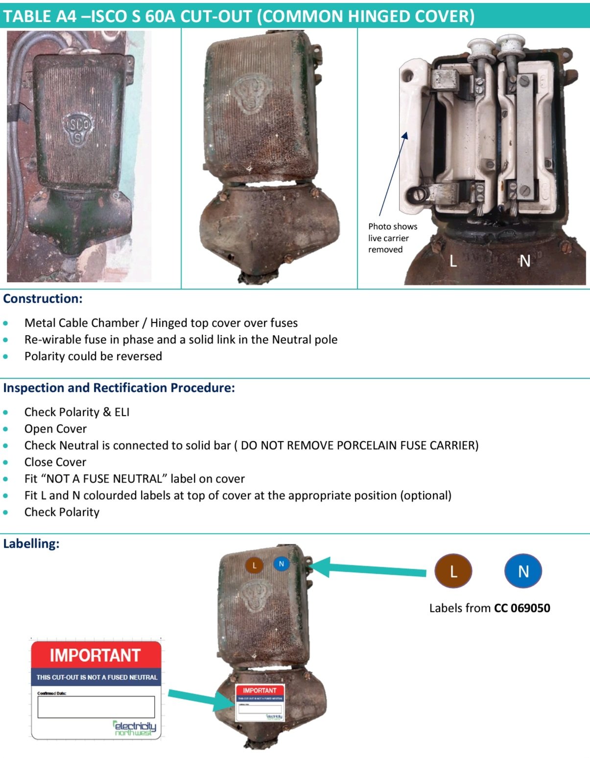

My image suggests no fused neutral. Not all ironclad cutouts had a fused neutral but it is well worth reporting.
