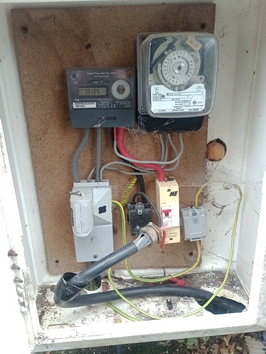

This is supplying a small commercial set up. SWA is only 16mm and the isolator is rated at 100A. Earth cable between MET and SWA is only 10mm.
How would you code it? Having a brain fart and thought I'd seek other opinions.

Poor workmanship certainly the Swa needs proper protection KMF 60 amp
2Core not ideal the armouring, when terminated correctly, may be sufficient for CPC, but not for Main Bonding Protective Conductor😎
I’d say there’s been a proper set up before… with the gland into a box.. seeing that there’s a shroud there.
Also old screw holes in the back board suggested there’s been old equipment removed…. Like an older style meter.
Agree on C2 for unsheathed cables…. It may be in a lockable enclosure ( hopefully it’s got a door and is lockable!) but it’s available to untrained personnel to open up and read the meter.

Nope no fuse or MCB located anywhere apart from of course the 100A main head. I would assume they’ve used the rotary isolator just as a means to...
290
In the 80's I was taught that with PME earthing arrangements we used 16mm for the main earthing conductor, some went a bit crazy and were bonding...
