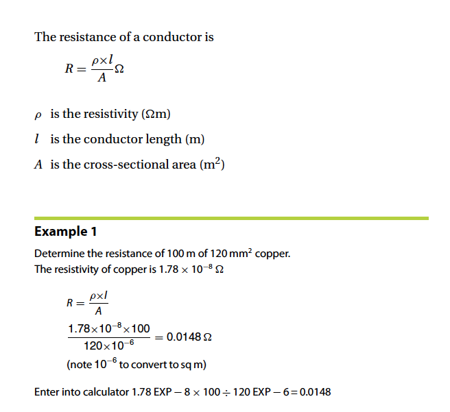

A question on resistivity as thats we have just been doing...
In the following exercise take the resistivity of copper as 1.78 x10-8 Ωm.
Find the cross sectional area of a copper conductor 42m long which carries a current of 36A with a voltage drop of 2.69v.

I found that one a bit tricky when we did these at college, if you struggle with it i can post up one of the example equations that we were given before we started the exercise as these were a real help when we were left to get one with questions.

That would be much appreciated mate as im not sure how to work this one out
Had to do a screen grab as it wouldnt let me copy and paste
Hi pennychew, we've just started this at college, so I'll give it a go! Is the answer 10mm2 cross sectional area? Cheers. Jim
