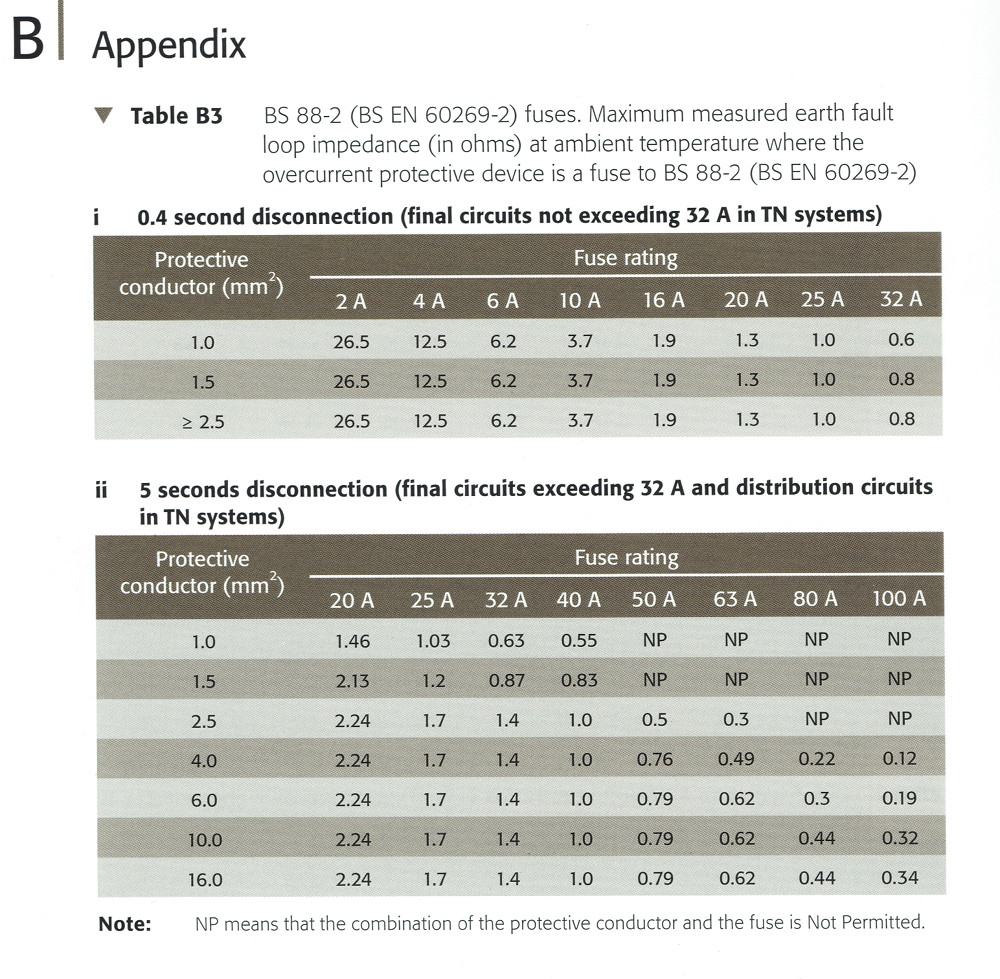

Then how could a reduced size earth in T&E be compliant unless the installer calculates it?
Because it is a standard circuit and it has already been calculated - the whole point of standard circuits is that all the factors have been calculated!
You could calculate it again, but why?
If I have a circuit using class 3 MCB type B up to 16A table B7 in the OSG tells me that is suitable for no less than 1mm^2 up to 3kA
Knowing this - I now calculate it again - Why???
OK, so k=115 the let through from 3kA based on a 16A mcb is 1.98kA, and the trip time is 0.003s (it's well above the inst trip into current limiting)
This works out as SQRT(1980x1980x0.003) / 115 = 0.94mm^2
Isn't that odd, you use the figures provided by the IET as acceptable - and when you calculate it - it actually works out!

Ill take your word for it. That if it means if means loop impedance requirements are met than the CPC will always be greater than what the adiabatic method would calculate out to be when dealing with T&E.
In reality few electricians have to use the adiabatic equation (though they should know how to) as the IET's On Site Guide has some useful tables that incorporate the information for circuit design. For example this table is for BS88 fuses and shows the maximum Zs values for different CPC sizes:
For example, if you have 10mm T&E cable with a 4mm CPC used as a sub-main feed so you could allow 5s disconnection, you might have a 63A fuse for short circuit protection only, and then the downstream DB can use a mix of MCBs up to 32A in order to provide overload protection with a reasonable chance of selectivity. Looking at the above table you see you max measured Zs is 0.49 ohms, so your final test at the nice new DB would be to confirm this is met.
Also you see the value is 0.62 ohms in all the larger CPC sizes - they are time-limited for the fuse action, where as at 4mm it is adiabatically limited (hence lower Zs for a shorter fault disconnection time).

Here are some printed tables from Hager and MK which may help with regards to the requirements of the cpc at different fault levels using class 3 current limiting mcb’s.
Slightly more to it than that, firstly you have to ensure the protection operates within the time limits (which is via selection of correct MCB and the Zs {loop impedance} requirements)
Then, secondly that the CPC is larger than the minimum size given the MCB type, class, and fault level.
So if I have a fault level less than 3kA, a 20A class 3 B type MCB then:
1) The Zs must be less than 1.1ohm (at the time of install - i.e. when cold)
2) The CPC must be bigger than 1.5mm^2
1) can be found from table B6 in the OSG
2) can be found from table B7 in the OSG
In which case standard 2.5mm^2 T&E can be used
Change the fault level to between 3kA and 6kA then again from B6 & B7:
2) The CPC must be bigger than 2.5mm^2
- In this case you can't used standard T&E , and is often the case for industrial sites where the CPC has to be the same size as the live conductors
(of course you would also check for volt drop, cable rating due to installation method etc.)
Above 6kA fault level then you need the manufacturers data and have to calculate manually (although there are other tables available - just not in the standard stuff)
1) The Zs must be less than 1.75ohm (at the time of install - i.e. when cold)
