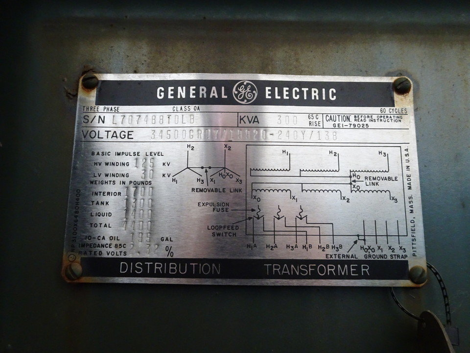

Not sure what the HV transformer picture is for!
Yes, the line-neutral impedance matters but generally speaking if you meet the voltage drop limit of, say, 5% then your PSSC is going to be at least 20 times the nominal current. That is usually going to result in 5s or less disconnection time.
If that is violated then you are looking at longer fault times and so both a higher exposure time to potentially dangerous touch voltages (if it also applied to the earth loop impedance), but also a higher fire/cable damage risk as the I2t is going to be huge due to the large 't' involved.
So back to the Ze value - it should be ideally enough to achieve the disconnect times. For a TN system you need the PFC to be broadly comparable to the PSSC demands from volt drop for that, but you don't want it very high as that can lead to issues in conductor damage, OCPD failure, etc. So some systems have neutral impedances included to limit the PFC to a sane value to allow differential relays to clear faults, allow end circuits clearing, etc, without a risk of damage.
Just that 138/240Y exists :p A while back several members expressed skepticism that such a system was in existence being that it is not common Europe.
