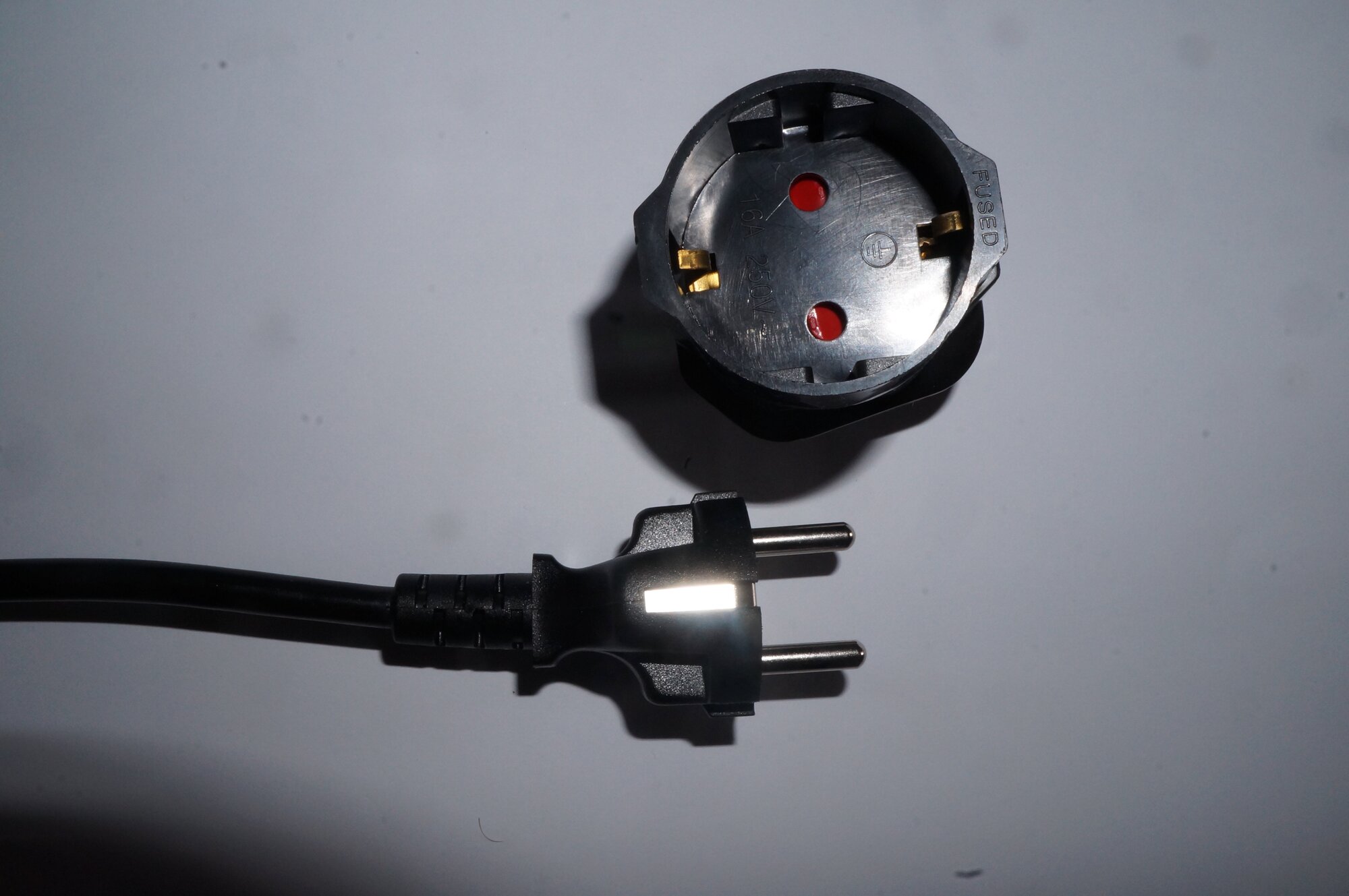

I have a treadmill with a two-pin EU plug and 16Av but my house needs an Ireland 3 pin plug, is it safe to get an adapter and voltage converter, if so where could I source that? I have only ever used appliances with 13Av in my house before so I am unsure if it is safe, advice much appreciated, thanks

What Voltage is the treadmill rated at?
You say voltage adaptor, if this an EU unit it should be 230v you need to check the specification of the treadmill to see what voltage it runs on, you also need to know which MCB (fuse) in your CU (Consumer Unit) the socket you are going to plug into supplies that socket run, a picture of the spec plate on the treadmill and a picture of your CU would help.
It probably just needs a high quality "travel adaptor", but as above, check the rating in the manual or name plate on the machine to verify it is for 230V and not more than 13A.

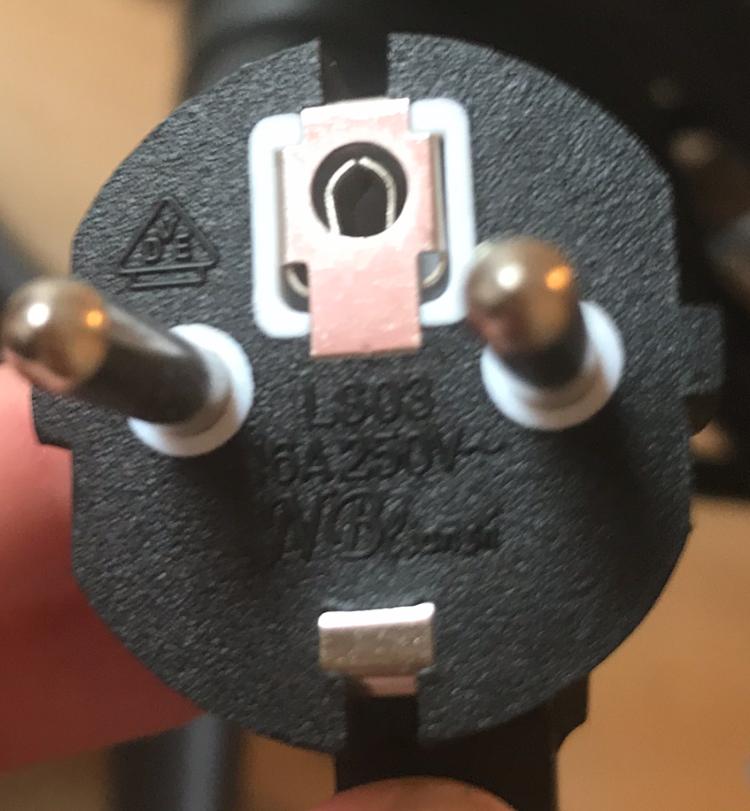

Thanks! Here is a picture of the fuse box and treadmill plug, the plug says 16A 250v

The plug from your treadmill is three way as the hole at the top is an earth connection, need to see the specification of the treadmill and know which one of the MCB's supplies your sockets?

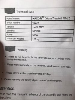

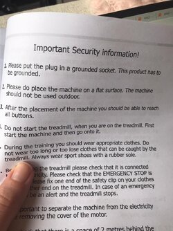

The plugs always say 16A, that is thier rating, but the equipment can (and often is) much less. Have you got a manual for it?
yes, the board has been around a long time :) I have a manual here which says 220-240v and on another page, it says to ensure it is in a grounded socket but I do not know what that would mean, thanks
