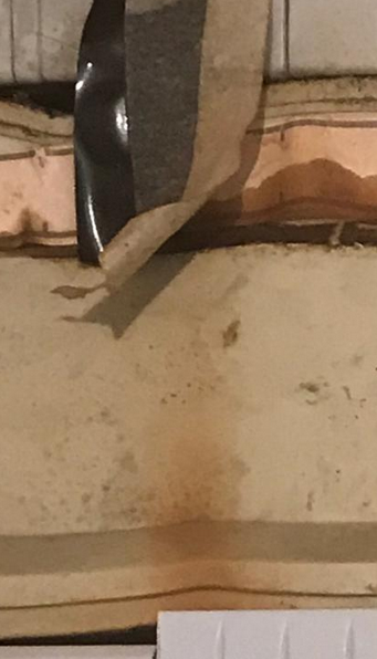

Thanks! Here is a picture of the fuse box and treadmill plug, the plug says 16A 250v
What on earth is going on here:
[ElectriciansForums.net] two pin 16av to three-pin uk plug
  • [ElectriciansForums.net] two pin 16av to three-pin uk plug
Yo, sorry.
But it wasn't so much the taping over I was concerned about, it's the overheating-verging-on-a-near-fire that has taken place
Probably should be condemned
Oh gosh thanks, I actually did not notice that. I think a few years ago there was trouble when the two power showers were used in the house at the same time so could have been that but must get it checked, is it a big job to get a new one?
Going by what is visible, the CU should have been replaced then.
Only the person who inspects and tests the existing installation can tell you how big a job it is to replace the CU.
