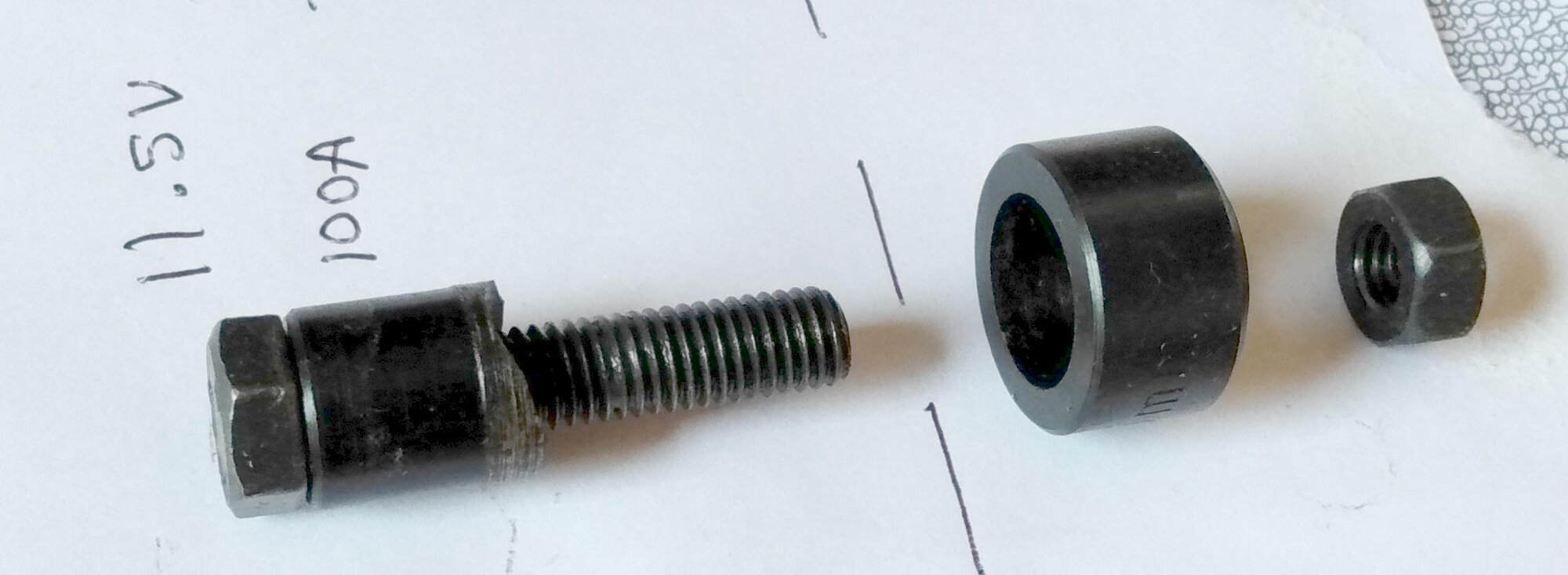

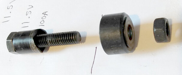

Hundreds if you look after it. Mostly making sure the bolt/nut is lightly greased and kept clean of swarf. You can usually replace the bolts part as well.
They make for a clean hole, slight burr on the pushed-into side, but quiet and free of swarf other than the pilot hole. If you need a medium size hole in sheet metal (say to 2mm steel) they are very attractive, though bigger ones need a ~20mm pilot so cone drill, hole saw, or two sizes punch operations needed.
Here are examples:
For smaller sizes, say to 20mm or there about, a cone drill or Armeg hole saw work as well, if you don't mind swarf (i.e. cutting before installation, without electrics to get contaminated with it). While I have hole sawed to 110mm its not a great experience and rarely that accurate a hole at the end of the day, a hole punch is far more civilised.
You also get square punches for switches, and special shaped hole punches for the likes of coax connectors (single 'D' for BNC, double D for Type N, or etc) that are great if you need them, but price is surprisingly high, as in £100-200 or more.

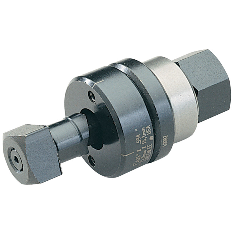

Here is an example of a D style punch:
RS and Farnell list far more Greenlee special hole punches, but prices are around double of those folks. Having said that, RS is often ex-stock while they are on demand and can be many weeks. Here is one I got recently, but not at this price:
They say "hydraulic operation" and you can get, at great expense, a matching hydraulic actuator but by default it has a nut and bearing so can be done using a spanner or socket set.

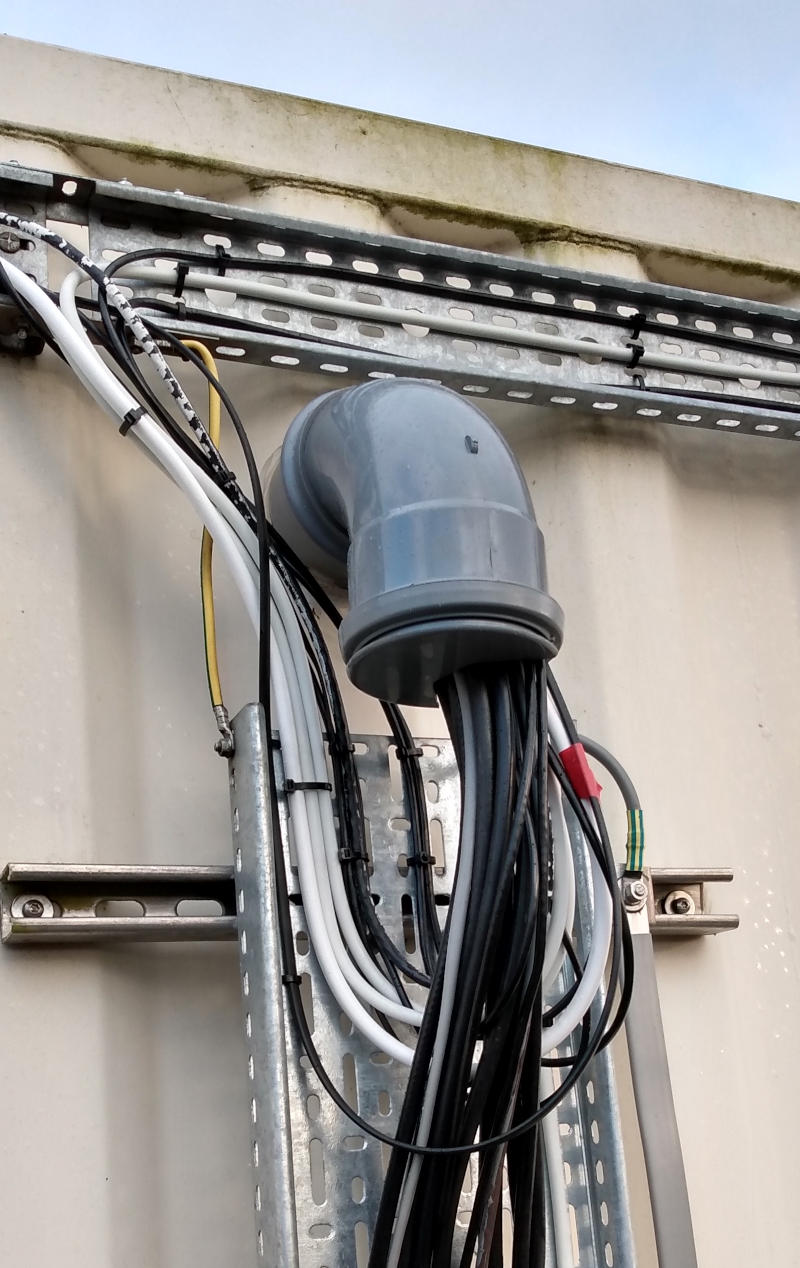

Was for some waste pipe as a cunning entry route for cables.
[ElectriciansForums.net] Type of drill to get?
To be fair, few electricians will be using holesaws above 64mm in steel. Larger sizes tend to be used in more forgiving materials and, if cutting a number of large holes (160mm+), I'd switch out the SDS chuck and let a bigger drill handle the strain.
True, it was unusual and as you can see above, not amenable to a hole punch anyway for all sorts of reasons!
