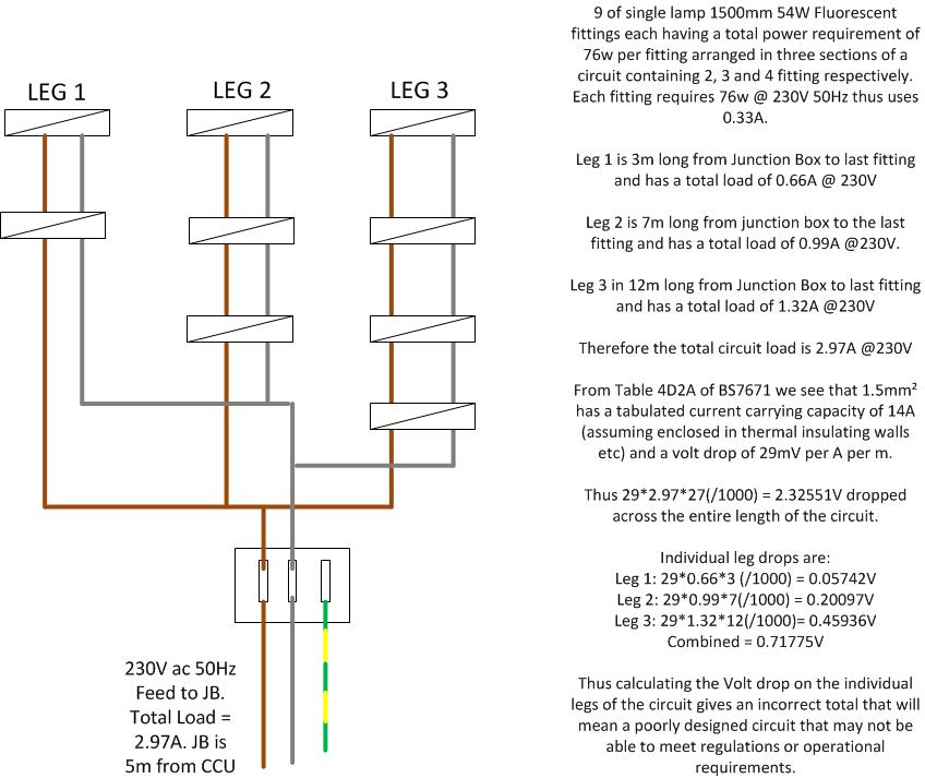

Ok I have another VD question. I'm installing 9 LED floods around my friends garden which totals at just over 100m in length. Obviously for each branch the VD varies so for argument sake I worked It out as if all the cable would be taking all the load (rather than dropping relevant current after each light, worse case scenario) the load is minimal being LEDS but to be safe I'm putting 2.5mm 3c hightuf in to cope with the distance and to help for the zs reading. Now I am also using a wise box control box (wireless switching) now am I right in thinking I can supply this box from the CU with a length of 1mm t+e as this is a very short distance and is my thinking correct that as long as no voltage has been dropped through the 1mm to the wise box then I have a full 230v (give or take) for the garden circuit and as its run in 2.5mm it will stop any VD issues. Basically what I'm asking is, whatever voltage you have at a certain point regardless of cable size, then that's what you have from that point onwards. I.e if I lost 3volts through initial 1mm cable then I'm down to 227v at wise box (for example)

However I believe that what you are saying is that if you have a branched radial circuit then the volt drop of one branch is not added to other branches.
In this you would be correct.
If you assume you have a circuit with a supply cable going to a junction box and then splitting to two cables (one going left, one going right) each of which has two luminaires, each at a different point along the cable.
The volt crop calculation would include the cable from the CU to the point of the first branch for the full load of the whole circuit; added to that would be the volt drop to the first luminaire on the left hand branch using the current load for two luminaires; added to that would be the volt drop to the last luminiare on the left hand branch using the current for the last luminaire. This would give the max volt drop for the left hand branch.
Then you would calculate in the same way for the supply cable, the cable to the first luminaire on the right hand branch and the cable to the last luminaire of the right hand branch. This would give you the maximum volt drop on the right hand branch.
The highest of the left hand and right hand calculations would be the maximum volt drop for the whole circuit.

Voltage drop can only be calculated along the entire length of a circuit for design purposes. In your example the Voltage drop on the supply to the JB is ZERO because to measure this properly you need to disconnect from the branch to avoid loading by the installed fittings, and as there would be no load then there would be no volt drop.
This section of the circuit will suffer the maximum voltage drop on the circuit, the voltage drop on the branch sections is irrelevant in this example because the circuit should be designed to take into account all the volt drop along it's length.
This is why we use the equation VD=Mv/A/m

Is this a ruddy wind up or do you simply not see it...Calculating the individual legs of a circuit will give an inaccurate final figure, you need to calculate for the whole circuit...see this I have just knocked up for you..

I was taught that way at college. The reason I'm struggling with this is because not the entire length of the circuit is taking all the load stated. So therefore they must be dropping different voltages across certain lengths. That's why I don't get it. Clearly I've been taught wrong. Sorry to frustrate you.
liken it to a bus load of 60 passengers. bus drops off 10 at the first load. so it's now got 50. at the 2nd load it drops off 5 more. so now its lost another 5 on top of the 10 already lost and now has 45. . and so on.

the lowest voltage will befoundat the kast load, but the biggest vd is on the 1st section, as that section from the ocpd will be the only part of the circuit carrying the full load.
