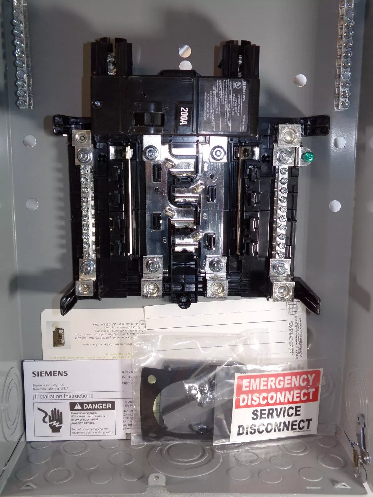

i had my house burn down last oct. and i had the 100 amp service panel in the garage. and i had a 40 amp sub panel next to that and that fed to my back garage sub panel located in that back garage for that power, so now we are getting a modular home and it seems they will not or can not run the circuits up into the attic area and then let the local electrician connect them to a new 200 amp service panel that will be in the same location in the new garage.
so my question is this. they are doing a 200 amp for the house located somewhere in the house, and will have to put a coil of most likely 4/0 alum wire in the attic for the electrician to run into the garage to the same area the meter base will be. i know that will need to be fused and most likely at least a 200 amp main also, but what type of panel can i get that will also have some breakers in it so i can get my outlets and lighting circuits back in the garage and also allow me to run the 40 amp circuit back to my garage i have in the backyard to the sub panel back there?

thanks but i was looking to only have the meter base outside and the service in the garage. being the house is going to have a 200A service inside already. it looks like i need to put in some type of 200A panel and feed the house with the 200A main in whatever panel i get and then the other breaker slots i can use for power it the front garage and then going to the back garage as a sub feed.
i think i found this one that should work what do you think? thanks
Siemens 200A PNW0816B1200TC, 8 Space, 16 Circuit, Outdoor Load Center, Type 3R
this one looks like at the bottom or the buss bars i can attach the main feed going to the house and use the main in this panel as the main breaker for everything? i see the incoming lugs on this main breaker and it has slots for breakers to use in the garages and at the bottom lugs so attach the feed going to the modular house main panel. thanks
