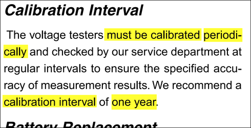

this is old post but I just came across.
Any testing instrument may require to be calibrated by the manufacturer. The instrument manual may have that recommendation as well as the duration recommended by the manufacturer to perform the calibration. Please see attached snapshot from the FLUKE T100 Voltage/Continuity Tester manual.
Any calibration of such usually conducted by the instrument manufacturer or by a well established and certified calibration house. If the company that is using the instrument decided to perform the calibration in house and by their staff then a procedure need to be stablished showing the work instructions, duration and the equipment used in the process as well as what the procedure is covering. i.e. which measurement tools are covered by this procedure.
