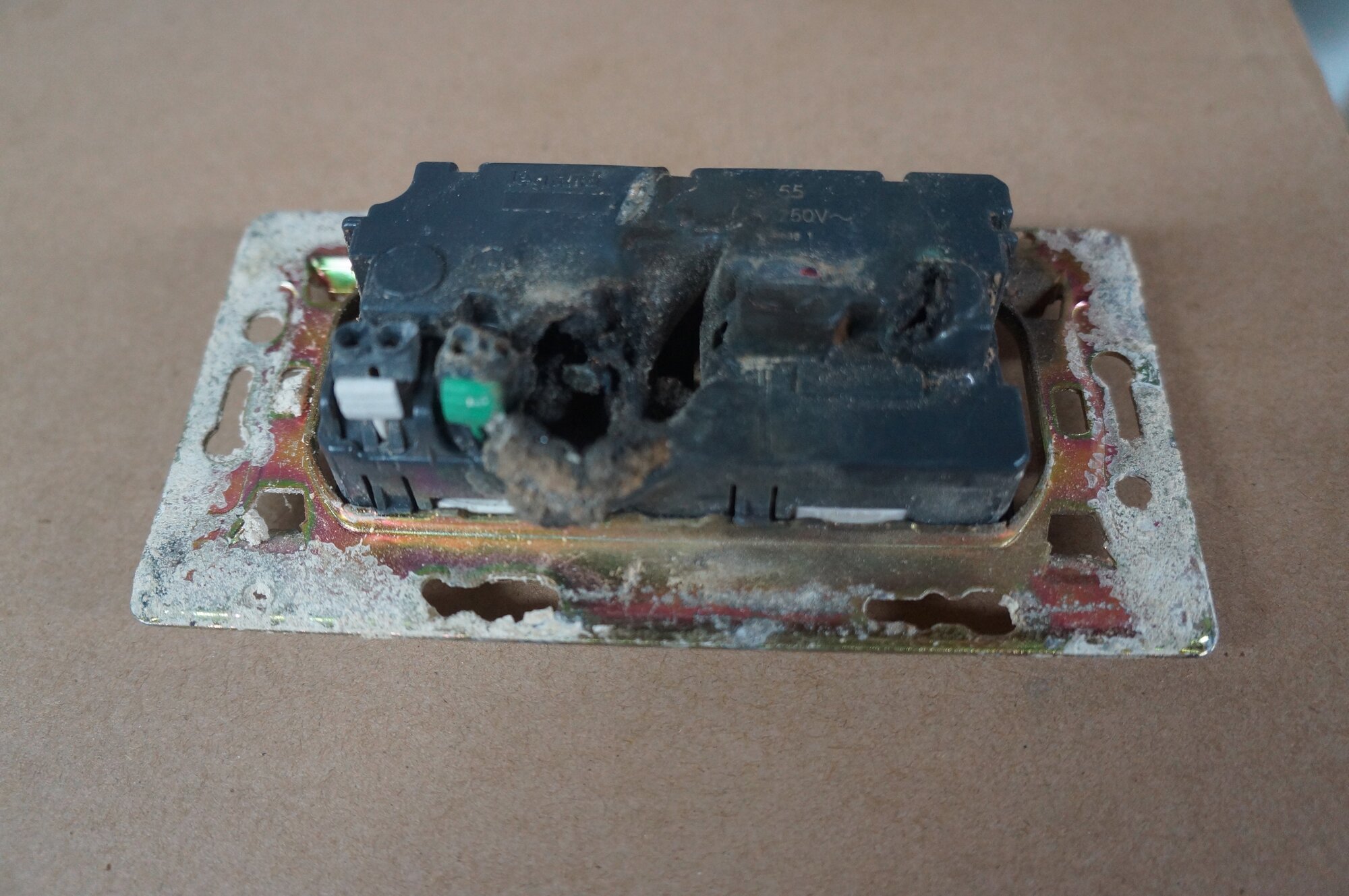

Two fan heaters on one double socket, need I say more, smell of fish gave it away.
Yes... I think I can see a “legrand” badge moulded into the back of it.
Interesting - didn't think anyone made one and assumed maybe the standard required screwed terminals. Though the terminals didn't help in this case apparently, but can't really blame them if you put 26A through it...
Not going to catch on unless there are 3 terminals per socket though.
It's a standard Legrand dual socket the small finger points above the push in connectors are to relive the push fit and allow the cable to be retracted, it did have three connectors at some point. ? Its a French standard fitting.
