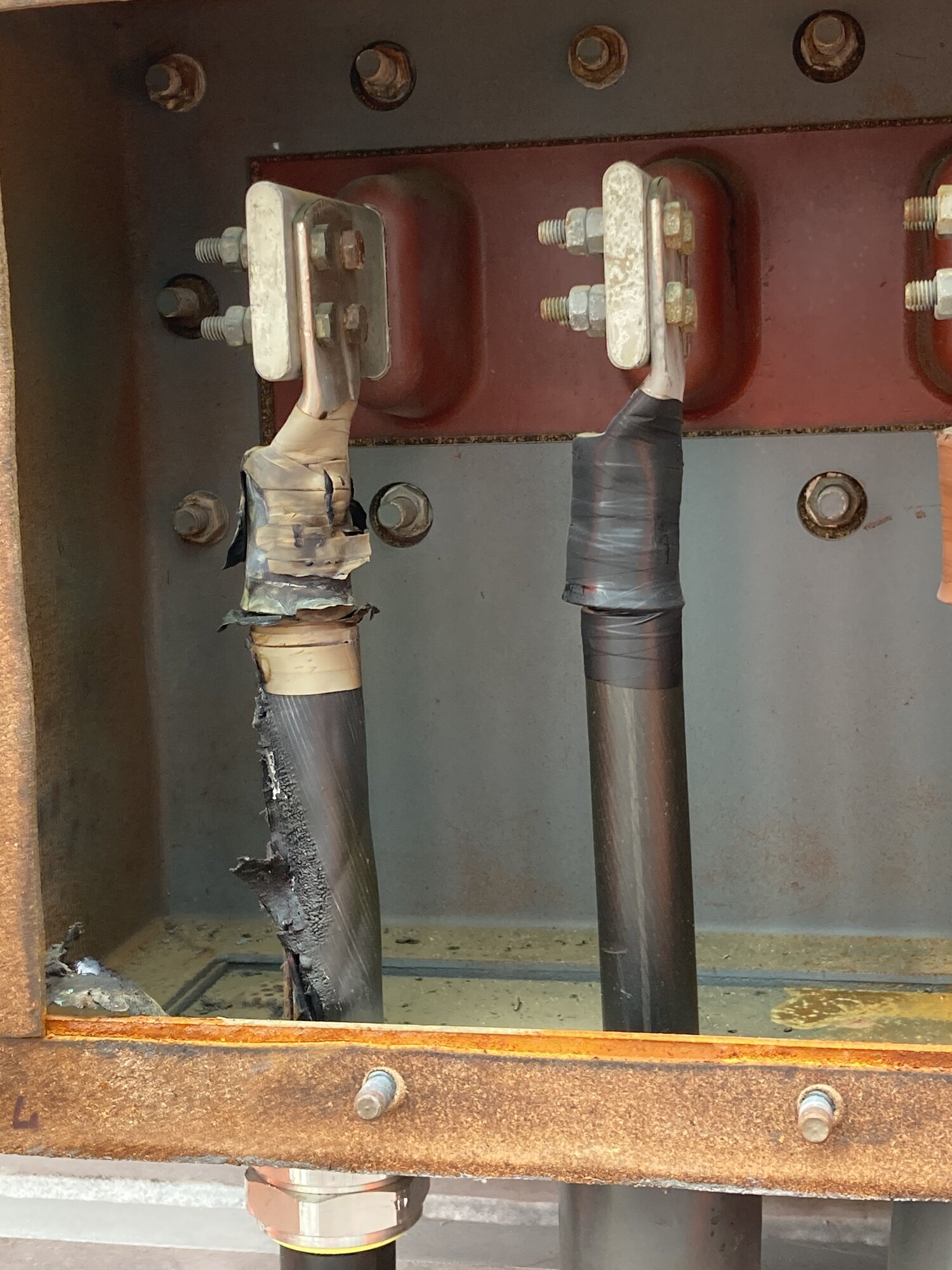

Just setting up a new sticky thread that unlike the dodgy trade pics thread is focused on showing the result of failures in electrical installations IE - damage caused which may be due to various reasons. Please do not post pics of poor workmanship if there is nothing else to show like the consequences, use the dodgy pics thread for that.
I will start off below with an example. I am hoping the fresh faced members and inexperienced can get a visual incite of what to expect when you come across such things and how to understand what has occured.
Loose connection
