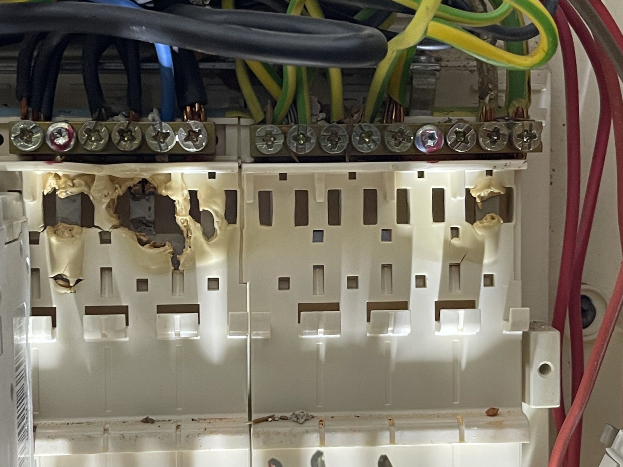

Just setting up a new sticky thread that unlike the dodgy trade pics thread is focused on showing the result of failures in electrical installations IE - damage caused which may be due to various reasons. Please do not post pics of poor workmanship if there is nothing else to show like the consequences, use the dodgy pics thread for that.
I will start off below with an example. I am hoping the fresh faced members and inexperienced can get a visual incite of what to expect when you come across such things and how to understand what has occured.
Got a call out yesterday afternoon. Told electrics had tripped, turned back on and keeps tripping every few minutes so could I come and check as had no power to sockets, kitchen and half the house.
Arrived to find the following:
Basically the far right breaker was a 50A supply to a second DB for one half of the house (big old farmhouse) which includes a 10.5kw shower, sockets, immersion and lights. Also 2 x 32a socket circuits (one of which was the kitchen) a 20a socket circuit and 16a second immersion.
All hanging off a 63a RCD and the board had never been checked in the 18yrs since it was installed.
So I managed to give them some power back. But told them they need a new board now asap and a full EICR doing, as I wouldn’t change a board without doing it anyway (especially not on house where I’ve been called to a melted board) and investigation was needed to check why that 50A breaker had obviously also overheating given the melted plastic around the busbar connection.

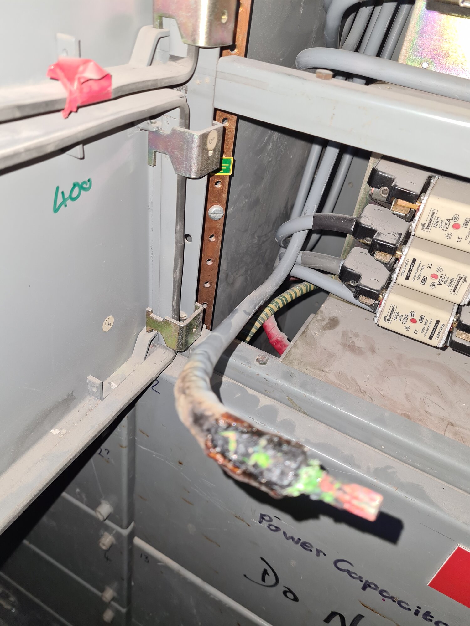

Shop in Dublin had refurb carried out end of last summer. New 35mm tails connected into old panel. Clearly someone didn't check their final connections. The same idiot also managed to break nearly every single cover on the terminals across every panel.
