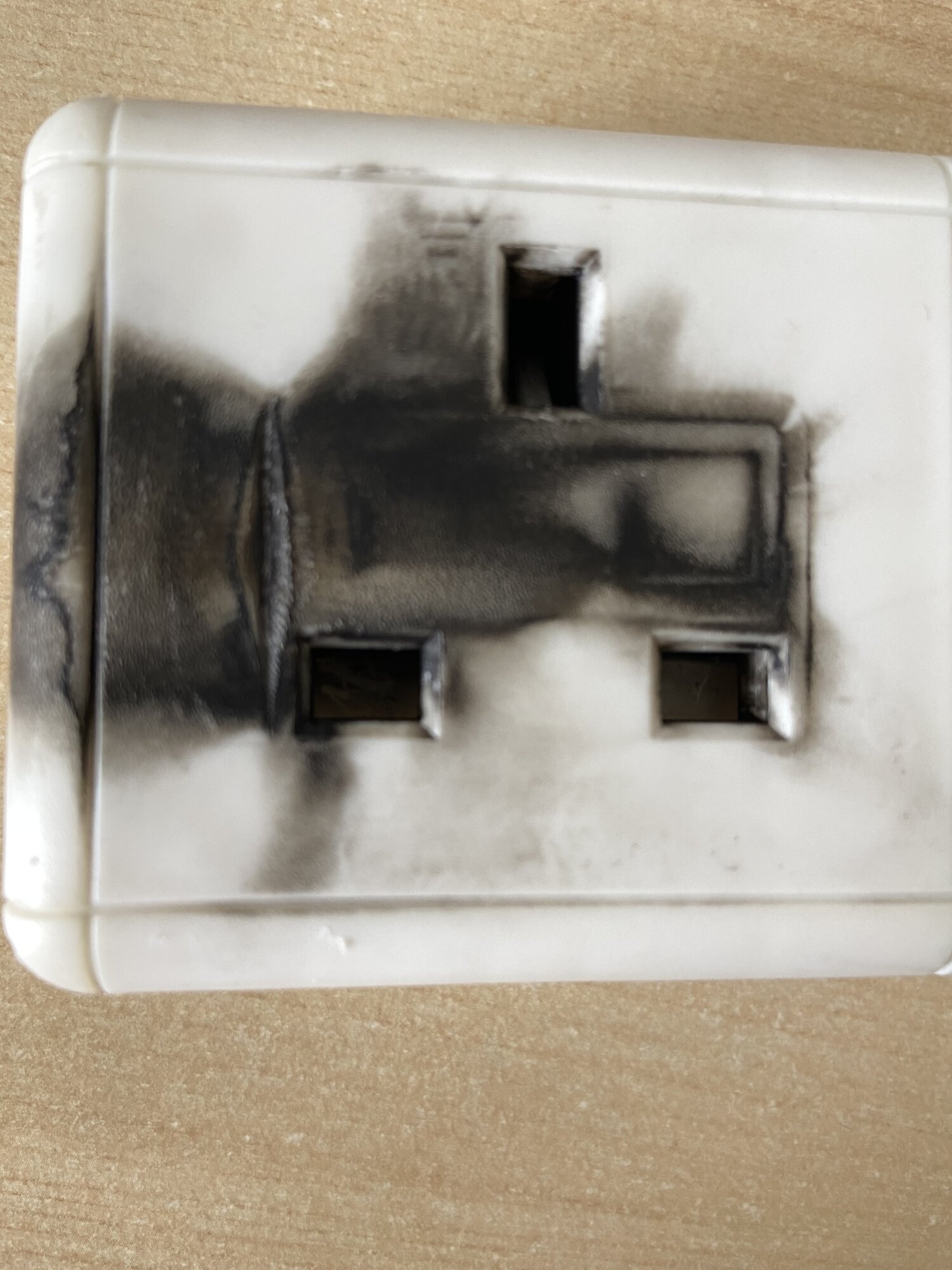

May I add this one (I had the offending sink waste disposal replaced by a plumber but I kept the old one).
There was a big bang and a breaker tripped. The tenant found this blackened socket. Where did all this black deposit come from? The molded plug looks undamaged - the 13A fuse was fine - can anyone explain what physically blew up here? I'm just interested.
I plugged the unit into an extension cable in the back garden and it blew the fuse in the extension cable (and left the same black deposit). The disposal was free to rotate so I don't know where the problem was.

Classic dead short between live-neutral or live-earth. The fault is nothing to do with the motor, so its spinning freely.
The black deposit is powdered charred metal. If you can visually inspect the plug pins with a good plug, youll see damage on the pins. The metal has laterally exploded into powder. If not the pins, then the socket youre plugging into.

Thanks for replying.
I had a look at the plug pins before I threw it all out - they looked ok which confused me (easily done...). I was hoping to see the black insulation that covers about half of the pin vaporised, but it looked OK. Although the 13A fuse was intact (electrically/physically), the "live end" connector in the plug that holds the fuse was much blacker than the other end. I thought the fuse should have protected something, but it looks like the short was somehow before the fuse. The disposal had been working OK for about 8 years and then "bang"!
My guess would be that a build up of dirt and damp eventually created a track which allowed an arc to form. Normally the distance is such that even when there's lightning induces surges about, you won't get arcing between L & N. But add dirt and moisture, and perhaps something sub-standard in manufacture, and you can get arcing. Once an arc forms, then the ionised air is a good conductor and the arc won't go out until either the power is cut off (the upstream fuse/breaker goes) or the arc is manipulated in such a manner that it gets broken. The energy in the arc can be "a surprising amount", and in all that black there is likely to be as least some it conductive material - so I'd be replacing the socket as well because it definitely doesn't have the arc resistance that it once had.

The socket is under a sink and although there was no sign of damp/leaks it could have got wet. I'm annoyed I didn't measure L-E resistance etc. of the disposal when I had the chance.
Here's another picture of the extension block I plugged the disposal in to see what would happen - note the burned groove to the left of the N hole and the edge of the extension is burned off and there's a nice image of where the fuse holder fits! (Fuse didn't blow). Powerful stuff.

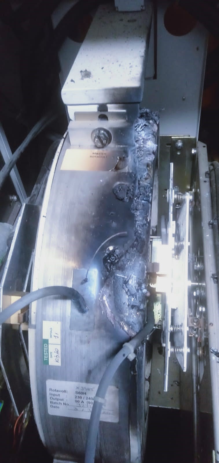

here's the result of a numpty damaging a brand new voltage stabilizer by getting the 3 phase connections on a generator wrong, and its all marked R,S,T,N. Connected a phase output line to the neutral and neutral to a pahse so it put two phases through the master rotavolt controller and left the incoming utility switched on while testing the changeover. By the time a replacement is shipped from UK looking at around 5K. Also took out the 400amp Auto changeover switch, another 3k to replace. Lucky not to lose the generator as well as it shut down within about 5 seconds of power being turned on. Thankfully the main switch in the MDB was off it could have run in to hundreds of thousands to repalce printers, photocopiers, and the data centre.
Lets just say he's not working for us anymore and will not be getting references.

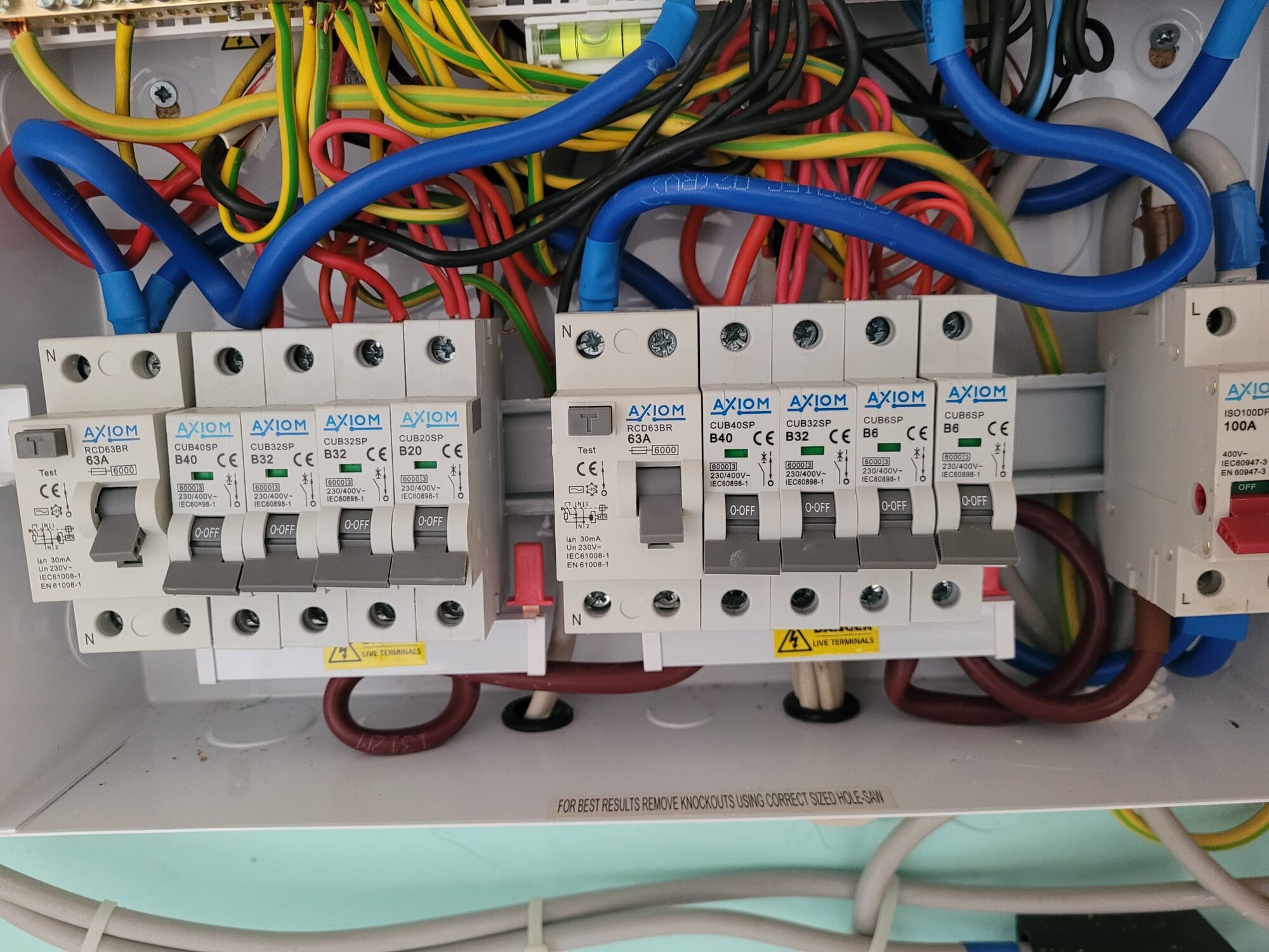

Had been running like this for 3 years - we got called in as they never got a cert off the original electrician and he told them to stop pestering him a few months back.
When put back correctly we found many isues that caused the RCD's to trip - shared neutrals, pinched neutral to back box in two seperate postions, switch fuse spur with neutral and earth swapped.
