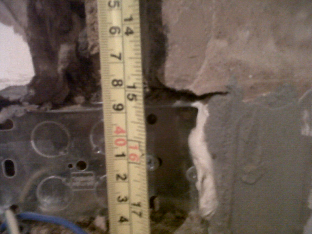

Yep! Edit button was disabled by the time I seen it. Hopefully the 15m/15m clarified what I intended 😀
