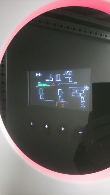

I know this is a bit off topic from the one you are helping me with but I was wondering if you had any thought about this;
I am currently also faced with the prospect of taking the inverter back to the supplier myself, as it is not working correctly. On re testing the pv Voltage at the input to the cabinet I have now seen it peak from what was 258v DC which is what I get from the 7x 420 w panels as their VOC.
I checked this at the point before I connected the cabinet as it has an input limit of 500vdc and it was fine, then after the F12 fault occurred I checked it again and found it went from 350 to 450 or more at the connection to the cabinet. I have since disconnected the PV from the cabinet as someone else told me that this could be damaging my solar panels.
The response from the supplier regarding the F12 fault was it was an mppt issue and the inference was that I had somehow caused it. Since I have only connected the PV, the batteries and the two plugs I can't see how but I will have to wait until they test it to see what they determine the fault is.
I subsequently started the inverted connected to the batteries but with the external PV isolator off and measured the input voltage on the pv inside the cabinet. With the internal isolator off the was 0vdc but as soon as the internal switch was on the reading was 150-180vdc at the input which can't be right. I know mppt is designed to get the best out of panels and in particular to assist if a panel is part shaded but I can't really say with any certainty that this may be the cause of the increased voltage at the pv input.
Do you have any experience of inverter mppt issues and if so are you able to shed any light on what may be causing this problem too. If you would prefer me to start a new topic for this then of course I will as I don't wish to cause any issues on the forum particularly as you have been so helpful.
Frankly at the moment I am beginning to wonder what I have bough and if I would not have been better buying all of the parts separately and installing them on a board in the cupboard to my own design. I wanted a self contained unit as it negated the need to size and design the contents myself but as it stands it has not fulfilled the requirement of a "plug and play unit". Don't get me wrong I realise there may have been issues if I had done this the other way too and that the problem may be resolved some how with a relatively easy solution. I am waiting for a solar installer electrician to contact me next week as he is away at present. Hopefully he can have a look at my system and test the earth and the protection device in the house, who knows it may be my house that is the issue!

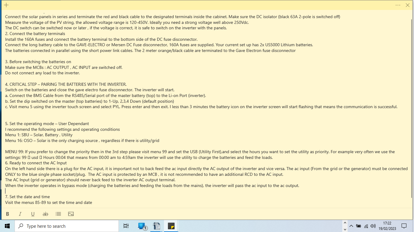

The consumer unit for the solar is in the external cupboard to be labelled as solar and not in the house. I have two types of sockets one for solar and one for the providers power, solar to be labelled as such when finished. I have attached a pic of the kitchen sockets) black is solar.
The incoming main supply is overhead and then in through the wall of the house to the meter and consumer unit. (also attached is earth arrangement in consumer unit).
I have output source set to SBU and I believe bypass mode must be enabled as when the timer is set to use the utility at night for charging it then makes power available to the loads as well as charging the batteries (albeit we would not be using any loads).
I have also attached a copy of the setup doc sent by the supplier with their recommended settings.
Battery charging priority is Solar only currently, recommended by supplier but I can set it to solar and then utility as I believe this is necessary to enable overnight charge from utility. This was set previously to solar then utility when we tested the utility charging timer on the inverter and it tripped the main switch in the house.

Hello Marconi
The issue with the pv input is this.
When I measure the pv input from the roof at the point it connects into the cabinet input connections (lower left in picture) I get the expected 253 vdc.
When the inverter is switched on but the isolator in the cabinet is off (lower right in picture), the voltage from the pv remains constant, when I then turn on the isolator in the cabinet for the pv, the voltage goes up to between 350 and 450 vdc.
When this happened I then isolated the pv supply using the external isolator I have fitted before the cabinet. Which effectively removes any input to the inverter from the pv, I then measured the voltage at the input connection to the cabinet and found the 100 to 200 vdc appearing at the input of the pv in the cabinet. If I turn off the isolator in the cabinet the voltage drops to zero, this led me to conclude that the dc voltage was coming from the inverter out through the input terminals in the cabinet.
Now I have no idea of how this is possible as this would indicate that the inverter is working totally incorrectly or that the inverter is somehow sending power to the point it is supposed to be taking it in.
When the inverter is on and working it only shows 252 vdc input from the pv (see Right hand pic) on the front panel of the inverter and it was not until I re measured the voltages of all of the terminals in the cabinet whilst trying to find any indication of what may be causing the problems I am having I discovered this issue.
I am somewhat concerned that this may be down to a wiring issue in the cabinet or the inverter but it is difficult to determine which without removing more wiring. Perhaps when I come to remove the inverter this weekend I will measure the voltage at the input connection to the actual inverter with all wiring removed to see if it is as above, when there are no other routes for the voltage from the inverter itself.
Feel free to ask for more information if this is required
Many thanks as ever and Regards
Tonyboy

View attachment 106299 View attachment 106300

As for suppliers instructions well I got the inverter and Bluetooth battery monitor manuals and nothing else, hence the ongoing thread and the advice I have been getting.
Many thanks for the reply and if the tests I do today do not help I will look into an isolating transformer. I am assuming this is something you fit between the ac input to the cabinet and the ac input to the invetrer and the isolation part is isolation of the earth back to the grid supply?
