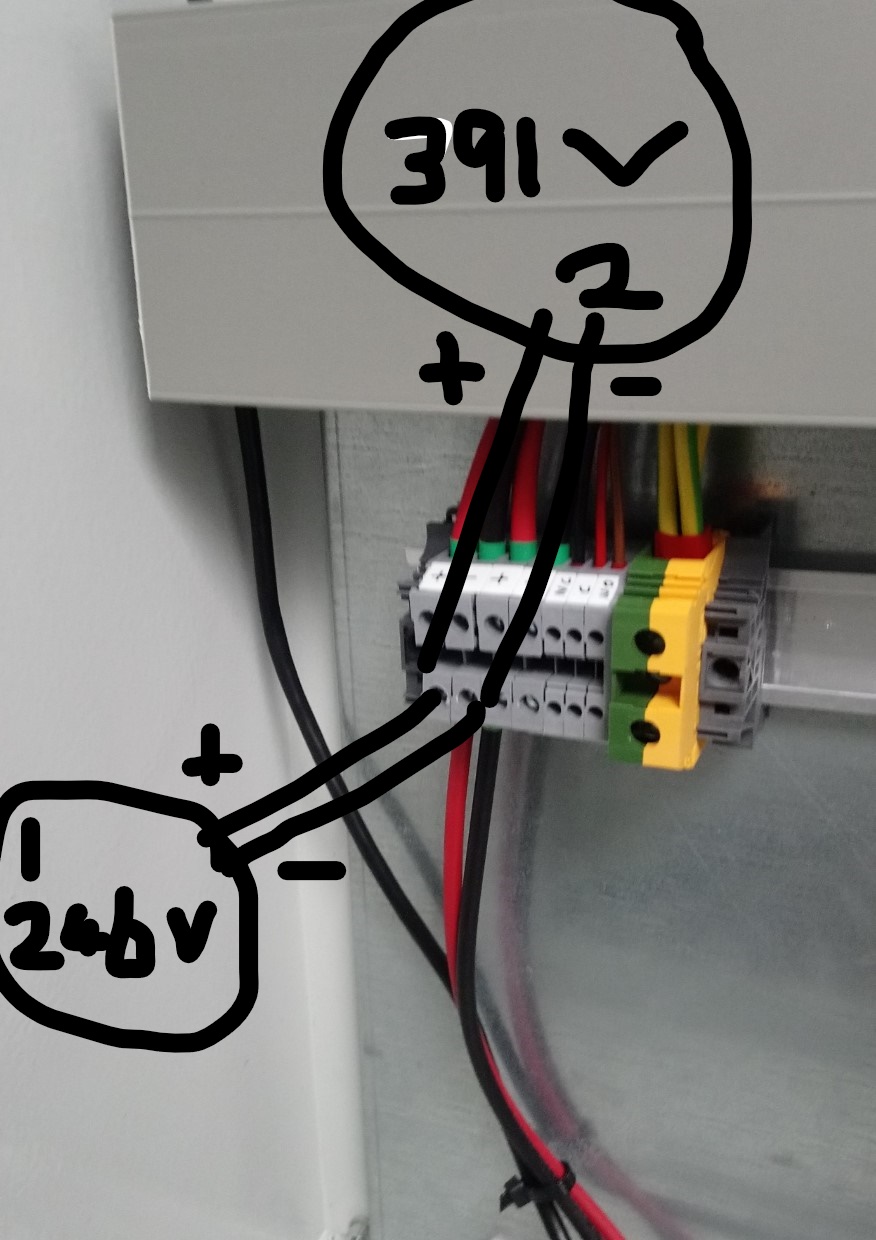

Hi Marconi
I think I have slipped up in the reply, it should have accompanied the message I sent before about adding a drawing, so I have replied in this message. I have attached a couple of pictures of the points I took my measurements for the earth and PV which I have somewhat rudiment ally marked with my mouse, I have added a short description to go with it to clarify the drawings.
The first measurement on the pv string input of 246vdc is with the inverter off and the main isolator from the roof on.
The second is measured at the same point on the pv input is with the inverter on and the isolator from the roof on.
The earth is measured at the earth bus bar in the cupboard, it is the cable from the pv array and rails on the roof and the bus bar is not connected to the earth rod as I have issues with connecting a cable showing 130vdc + to the earth rod that the two pylontech batteries are connected to.
Hope this makes sense.
Let me know if you require any more information and many thanks as ever
Tonyboy
Have you reported the state of the inverter on/off correctly for voltages 1 and 2 above? I would expect voltage 2 when the inverter is off to be round about 7 x 50 = 350V and voltage 1 when the inverter is on and MPPT operating to be lower eg your reading of 246V. The open circuit voltage of a panel is about 50V.
The 130-170V reading of the array metalwork to earth rod is to be expected due to the distributed insulation resistance of the panels and cabling to ground. For evenly distributed insulation resistance to earth the voltages would be half the +ve to -ve voltages so 350/2 = 175V and 246/2 = 123V - near enough what you measured.

With regards to the two readings. Reading 1 is the inverter off reading and it is derived from the open circuit voltage of the panels at 37.6 v each. When measured at the roof it was 253vdc which was a combination of the top string of 108 vdc and the lower of 145 vdc. At the isolator and input point on the cabinet it is 246vdc which I assumed was as a result of some loss in the cabling run from the roof to the cupboard.
The second reading is when the inverter is switched on and is between 268 and 391 vdc give or take. It does go up and down and I assume this is as a result of the mppt fault present in the inverter.
If I isolate the pv string and measure at the same point I am getting well over 100 vdc or more at the input to the inverter with no pv connected i.e. the input side to the inverter is showing a dc voltage output of this voltage. This is what is concerning me as I had assumed that there was no way for there to be an output present on the input to the inverter. My thoughts were that the mppt fault is something that is allowing voltage out when it should not be doing so, this output can only be derived from the batteries connected to the cabinet as at the point I measured the voltage the AC was off.
With regard to the earth cabling voltage reading from the array and panels, does this mean that it is safe to connect the earth cable to the ground rod then? I have the 2 batteries connected to this at present.
Am I correct thinking that the distributed insulation value is derived from or related to the grounding of the cables in the cabinet via the neutral to earth link that is present in the inverter.

To observe a voltage between the PV input terminals when the array is disconnected from them and the inverter is producing an ac output using power form the battery is normal. The solar inverter is transformerless which means there is no air gap between the dc inputs (PV and battery) and the ac output. Due to the way the dc input is converted to a higher voltage and then switched in polarity at the mains frequency and also the earthed output neutral there is an alternating voltage waveform ( square wave shaped ) impressed across the PV+ and PV- inputs. It is usual and nothing to worry about but of course don’t touch live connections!
The 130V dc ( circa half the end to end array voltage) between array metal work and an earth rod is normal when the insulation resistance is uniformly distributed from the plus to minus side of the array and neither the pv+ nor the PV- is connected to earth which they should not be. They are left floating.
You should connect the array metal work to a local earth rod so that the touch potential between the metal work and local ground is small.
I will provide further advice on earthing arrangements for the SP5048 cabinet in a later email.
Regarding the F12 fault code - does it occur in battery only mode, PV only or both battery and PV? Does it occur when the inverter is not supplying the ac output Load ? Does it occur when the battery is fully charged and not supplying any ac output load? Does it occur on switch on of the inverter or some while later? Does it occur when PV only is supplying a small low wattage load? Does it occur battery only supplying small wattage load?
