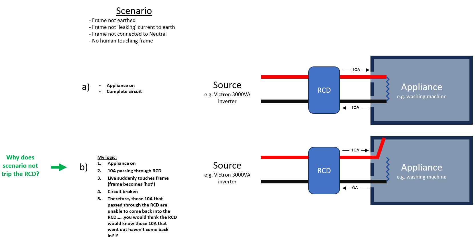

OK, so everyone keeps saying an RCD needs a complete circuit to work (and I'm not disputing that).
However, It still makes no sense to me why an RCD can't detect when a perfectly working circuit is suddenly lost (with regards to my scenario), especially if it's lost whilst current is running through the circuit.
I've drawn a diagram to better illustrate my point:

In the 1 st scenario the return current in both the L and N are the same (balanced) so the rcd won’t trip.
In the 2nd scenario there is no current flow at all because the frame doesn’t connect to E or N so the rcd won’t trip.
It stopped flowing the moment you broke the circuit.
in the same way that the current (Amps) flowing through your lounge light stops flowing the moment you turn off the light switch.
