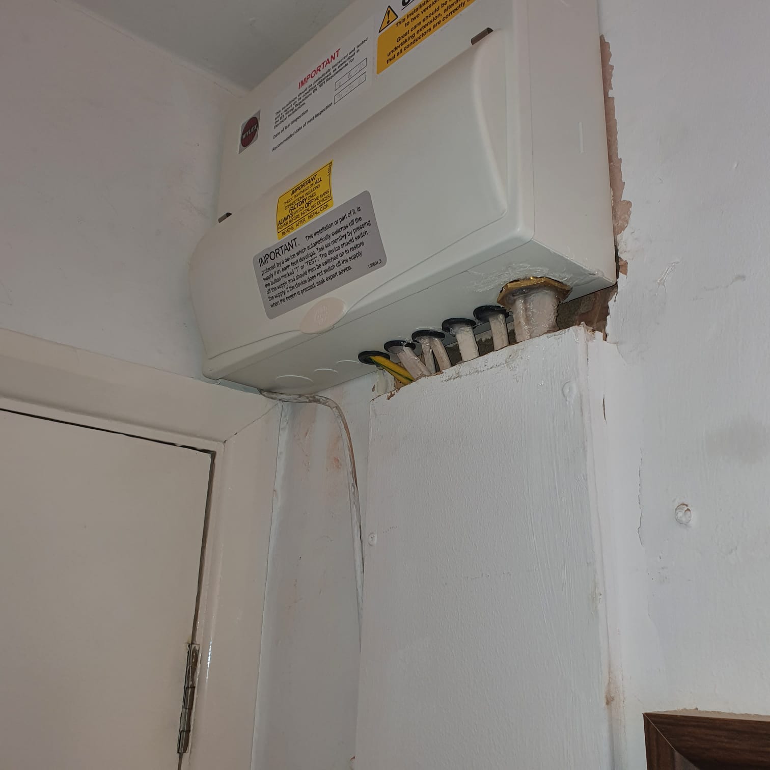

UPDATE: The consumer unit was replaced this week. I am waiting a new EICR that was completed as part of this. Here is a picture of the finished article and I would appreciate your feedback.
The electrician said that the gap was due to the difference in size of consumer units and I would need to make that good. I assume that is normal practice.
Can I please have some suggestions on how I can finish that off please?
Thanks again.
Main thing is it's safe. And if a fellow sparks has a silicone fetish who am I to judge?!
Basically construct something with wood to cover it.
What comes to mind is a batten on the top of the boxing lid (carefully attached to miss cables and so the lid is still removeable) and a bit of hardboard attached in turn to that extending up in front of cables.
OR two triangle side pieces screwed to sides and a bit of hardboard on the front of them.
