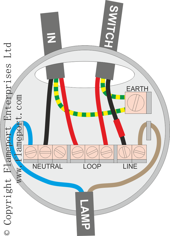

You guys obviously prefer to make people feel bad rather than give out advice - not exactly very friendly to new members but hey I can take that . Yes I did note the wiring prior to disconnecting the original light and I put the new light in exactly the same way. If the switch was blown how would that manifest itself - would the switch not work the light and it would not switch on at all?

Yea, they have nothing better to do with there time, u need to find out witch pair of conductors goes to the switch that's all

@ OP. you have 2 tingly reds they go together. then the black that tingles when you switch the switch is a tingly black and that goes to the bulb. the other black is not tingly unless it,s got an open circuit back the the magic box of fuses and the switch is on with the bulb in. this black goes to the other side of the bulb.

There may be an earth wire in the incoming cable connected to the back box, reading a few clues in what I can see, this wiring looks to date from...
