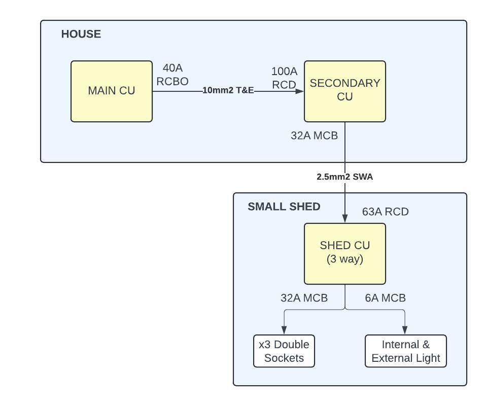

I'm looking to get the lionshare of a small shed wired before a friendly electrician does the needful. I'm a confident DIYer, but I would appreciate any more experienced view to check my logic.
My house was professionally rewired in 2022, but I would like to connect a small 8x6ft shed to a secondary CU that's close by. Connecting to the main CU would require too much upheaval.
The shed is small, but I'm planning to install a few sockets for charging power tools and occasional use of garden tools - plus an internal and external light. No big loads.
Obviously, it's a very simple issue, but I'd appreciate a more experienced view on any issue with my connecting to the secondary CU. The 12m SWA run is clipped externally but fiddly with tight access, so keeping that deliberately light also. Just keen to avoid anything daft before my friend sees it!
Many thanks in advance.
Am I seeing 3 RCDs in series there 😁

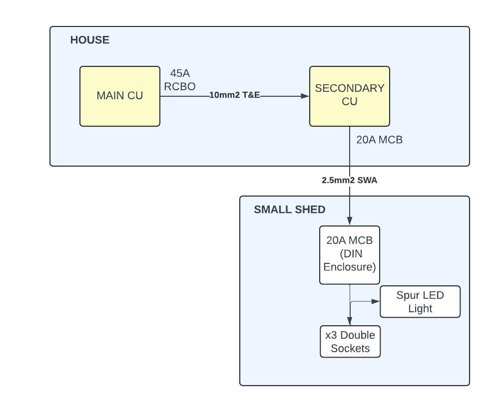

Quite right - seems this was a diagrammatic error upon checking, thank you. On checking the secondary CU does not contain an RCD. I'm now thinking this is overengineered for my purposes and that I'll just put in some SWA, and my friend can hook up a simple radial circuit when he gets time. Much thanks.
Have you done the calculations on the 2.5mm SWA?
