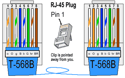

I have installed a new Cat5e cable (about 10m) between my network hub and a new office outlet. The cable does not light up with my cable tester (with new battery). I made a test lead with all pairs shorted out to plug into the wall socket and a second socket (to accept the new RJ45) wired to a choc-bloc. I get 0 ohms on my multimeter for each pair of wires, but still no lights on the tester and no signal detectable on a laptop. Any suggestions how to work out whats going wrong?

Are you sure each pair is 'the right way round'. Testing by shorting a pair at the far end, and measuring the near end, would show 0 ohms if inadvertently reversed!, but the tester would not register?
One end is an RJ45 socket module (the office) and the other end (the hub) is an RJ45 plug. Yes I've checked that the orientation is correct, but I'll sleep on it and check again tomorrow, Its easy to convince yourself that your seeing what you want to see after a while.
I assume you have the correct crimp tool for the plug and correct punch down tool for the socket.
the socket should have colours marked on it. use the colours marked B and the arrangement above for the plug and all should be ok
Trust you're connecting wires using a consistent convention pin-to-pin, rather than just following colours marked on the socket etc.
If you have a T568A marked socket, but you're wiring using T568B convention, it won't work (though in that case the continuity tests wouldn't pass!)

Thanks. Well it seems you've done all the right things. If it were me I'd try buzzing it out, eg from pin 1 on plug to pin 1 on socket just to make sure + and - aren't transposed somehow. I know that would be a pain.

Sorted now. Turns out Avo Mk8 was on the money. The plugs were upside down (White/Orange on pin 8 not pin 1). I just got to a point where no matter how often I looked, I just saw what I expected to see, not what was really there.
