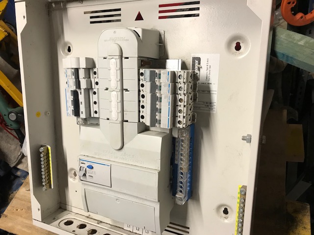

I know it's larger than you want but I have a couple of Invicta (hager) 3PH boards and some MCBs triple pole and single if you decide to make more room. If you even can. Just thought I would put that out here.

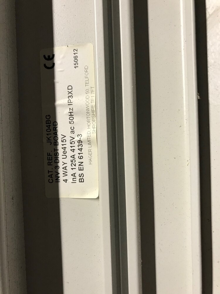

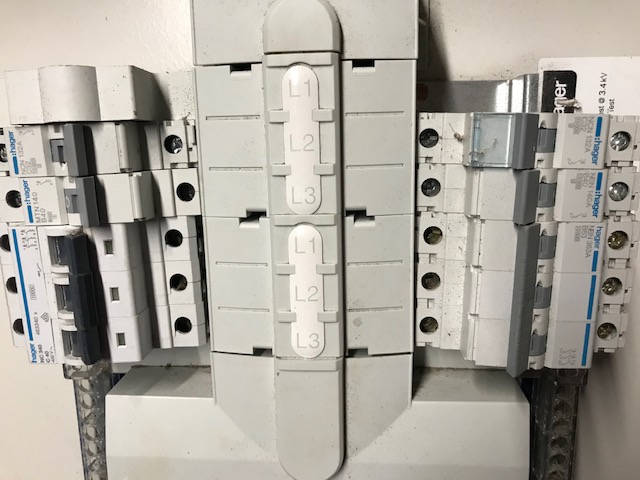

This sort of thing x 2 The MCB and triple pole are not screwed in so that is why they look a bit wobbly, could find the number on the lid if you need it. I just could not throw them away as I took them out they are a nice bit of kit.
[automerge]1596655850[/automerge]
Here it is the number I mean
