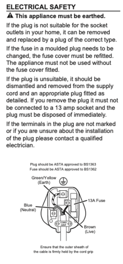

I'd have to say yes as there's no double insulation class II symbol anywhere on the (nearly new) machine, even though it looks very, very plastic. Rather thick (unmarked) lead and (annoyingly) a moulded plug.
The instruction manual contains this section, though there is no mention in the specification of Class of equipment.

Is it a reputable make? I'm surprised it doesn't state class 1 or 2 in the manual.

Sorry have probably confused a bit. What you have is a Class I appliance however all the earthed components are encased in what is essentially a Class II enclosure but realistically the appliance is Class I so I called it Class I/II but it is Class I.
I agree. It has to be a class I, since there is no class II identifier either on the appliance or in the manual
If it's not marked it must be Class 1.

The first line in the manual as shown in the photo above says "this appliance must be earthed".
Therefore it is Class I.
