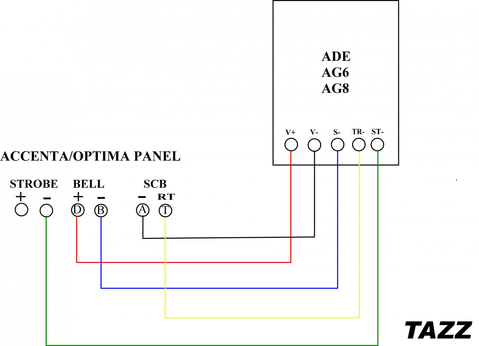

Hello, I'm new here and after some advice. I'm installing an Accenta Mini G4 Alarm with Honeywell AG6 Bell (SAB). I tested the system with a battery only and everything seemed to be working fine - once I fixed a fault on one of the RKPs. My problem is now I've connected to the mains and apply the battery link to the AG6, the bell sounds and won't go off. Removing the battery link silences the bell but it won't then trigger with the bell test function from the panel. Everything inside the house works as it should and when the alarm is activated the internal siren sounds. I also can't get the strobe on the AG6 to work. I've seen posts on other sites talking about problems with the AG6 but not many solutions. Can anyone offer any help please?
Thanks
hi Accenta 8mini g3 to a honeywell ag6 bell box? can anyone send the way to wire
as when I do walk test the alarm box clicks no strobe the led`s chase which says all
also when I do sounder test no sounder can anyone help
Heres the wiring diagram for bell box,

The previous bell box worked fine. I think it was just lacking the added security of anti tamper. Can this one be wired the same?
