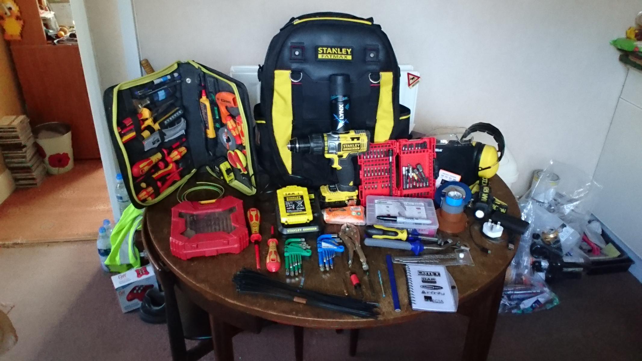

I've added to mine in the last few months: 160mm Teng snips, Teng VDE screwdriver set, another set of Knipex grips, a new pair of Knipex shears (ones in pic belonged to boss and were already passed it), Wera allen key set, ratchet crimpers, CK ferrule crimpers (non-ratchet type, still waiting for these to be delivered), new spirit level as mine wasn't level!, twin 10.8v Makita set, new hammer as someone robbed mine, new measuring tape as dropped mine into a stud wall! And just ordered one of these too:

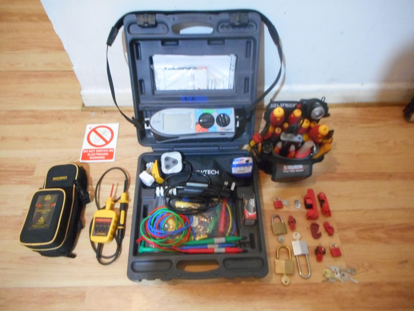

Can't help myself. Another few bits and pieces recently but most chuffed with this. Not a Facom or anything too fancy but had it a week now and it's definitely an upgrade on my old one. Was about forty quid :)
