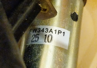

I have an issue with my shower and I suspect it's the solenoid.
The original fault is that the shower either wouldn't switch on at all, or it very briefly powers on, see video
I removed the front panel and as you can see below, manually pressing the plastic arm starts the water flowing, and it is heated too (i know the danger of using the shower in that state whilst live) so there is no issue with power reaching the unit.
I suspect that the faulty part is the solenoid, but is the part (arrowed below) actually the solenoid, as it doesn't look like other I've seen?
And if so where can i purchase a replacement? P/N FW343A1P1
Many thanks

Cannot view your videos for some reason but had a similar problem with one of these in the past. I cannot remember exactly but seem to remember there were a couple of spring loaded plastic caps inside the thing which were packed with some sort of grease that had gone solid. Cleaning it all out and regreasing with Vaseline sorted it out.
I'm having the same issue. Removed the front cover and inspected the PCB, it is indeed black behind the resistors that are connected to the solenoid. Continuity seems OK though, and they still measure OK.
I checked the solenoid and it has 4.8k across the terminals. I haven't managed to find a replacement or test an alternative yet, but I suspect the reason the PCB is being burned out (and some people need it replacing frequently) is because of the high resistance.

I measured 192 VDC going to the solenoid of my shower. Using resistors I found that it would operate down to about 96VDC. My PCB also burnt out similar to the other photos here.
I bought a "Motor Brake Rectifier MH-20TC Fast Motor Brake Rectifier AC200V/240V Input DC90V/108V Fast Motor Rectifier Output 0.8A 50Hz/60Hz" off Amazon.
Also a "Thinkbee Wireless Switch, 80~275V Remote Light Switch Kit" off Amazon.
This has fixed the problem for me. I left the old PCB in the panel but it no longer has a purpose.

Can't really follow this, but at a guess, I expect that you've disabled almost every safety device built into the shower.
