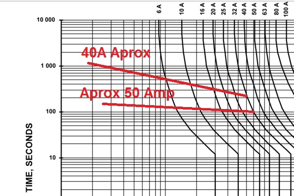

Hi Everyone,
I have been asked to install a cooker and hob built in one (total load 15kw ish), the customer has already 6mm installed from previous cooker so i changed the breaker to 32A b type (I hope this is okay?) and explained that it might trip if he is using the whole oven and all hobs which he is fine with. However we decided to test the breaker out so once installed we turned all hobs on and cooker but the breaker does not trip?? I was confused by this as I expected the breaker to trip, so I measured with my amp clamp and it was showing 47a going through and still not trip?? Can someone please explain or comment if you know why the breaker is not tripping as it's of big concern to me.
Thanks for reading.
MCBs will not immediately trip when their rated current is exceeded. A 32 amp B-Type will take 47 amps for quite some time before tripping. Its all in BS7671, unfortunately it's too early for me to put my cornflakes down and give you the page numbers!

Hi it was 40A type B and about 5m under floor boards and then chased in wall to worktop height for the cooker isolator switch. I didnt know the MCB could take upto 45 mins before tripping?! could not this be enough time to damage the cable??
Thanks again for replies!
@ OP. what was the previous MCB rating? how is the 6mm cable installed. i.e.ref. method?
40A B type, and the 6mm cable is under floor boards for about 6m and then chased in wall upto work top height to the cooker isolator switch.
So if the breaker can have upto 47 amps going through it for 40 minutes without tripping isn't that enough time for the cable to be damaged?!
Thanks for your replies too.
no, the cable rating allows for short term current in excess of it's rating. e.g. if BS7671 gives a value of 45A (6mm cable) then that value assumes constant load of 45A. 20% -30% above that for short periods is within the limits of the cable. obviously, if cable derating factors are applied, the current capacity will be lower., but a short term excess is allowed for . so you can see from MCB curves in app. 3 of 7671, that a MCB will withstand 1.45 x In for about 1 hour. this also means that the cable will handle it as well.
Whole chapter on it in BS7671, chapter 43, don't ask me to explain it all, though.
By the way, think 40amp mcb for 6mm cable (depanding on exactly what type of cable it is), is somewhat pushing the design envelope.

BYB page 325. Approximately about 40 minutes. However, the 47 Amps wouldn't have been constant due to cycling of the cookers elements.
If you saw my post before editing, I was wrong. I got the wrong lines in the diagram and my label for 40 Amps is in fact 60 Amps, it looks like the original 40 minutes is correct.
