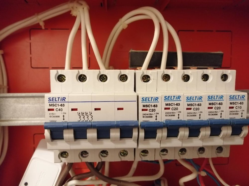

A wiring drawing and some pictures would be helpful plus exact numbers for the Ipower of under floor heating pads, cables, tiles. Please include the thermostats. This will help folk advise you.
Here we have the ground floor contactors. 4 thermostats (cheap copies of Honeywell and do not work well at all). Installing a central digital thermostat that will send a signal to the sonoff switch in the fuse box.

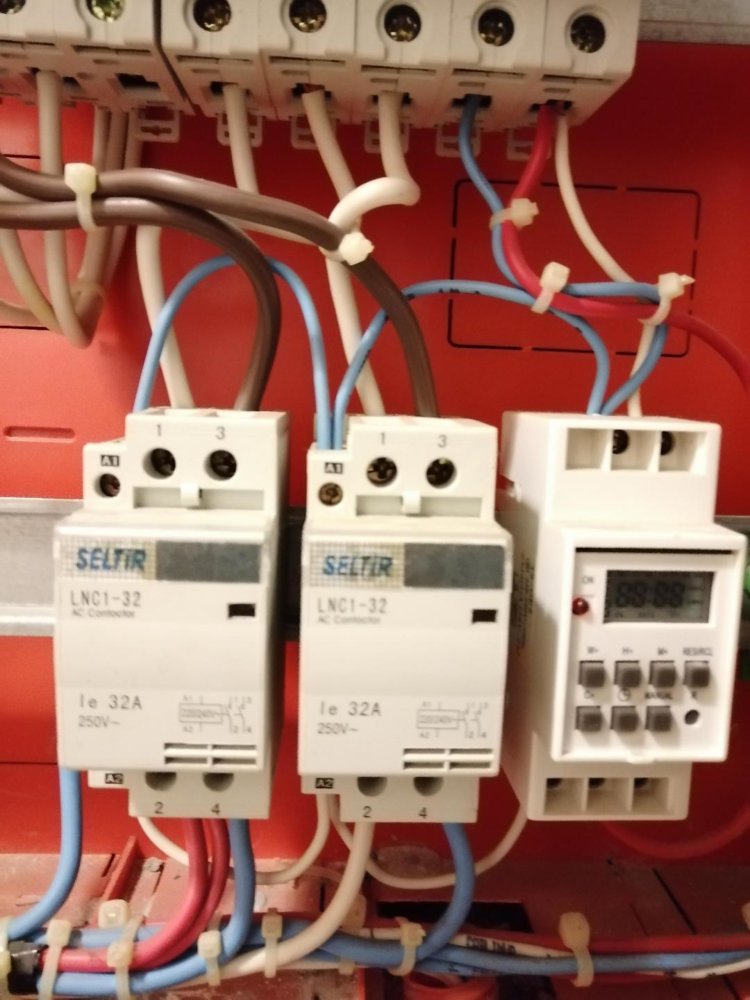

Would it be possible to swap out the 3 contactors here for 1 x 4 pole new contactor? How would this be wired? You see we have 2 Lives/ 1 Neutral cable set up coming in.
I see 3 sets of L/N cables going out to each of the 3 zones. I recently added the meters.

Could you take a couple more photos? One looking down on the black bar across the top of the 20A circuit breakers and one looking up to the contactors, timer and power meters?
It looks to me that the power meter and the time switch are unused - am I correct?
The wiring looks somewhat quirky so the extra photos will be helpful.
Who wired this up?

The timer on the right is now unused. Just the L/N being taken from the inputs to power the Sonoff R3 wifi switch on the left that I added this week to control the contactors. Much easier to set times and control virtually.
The 3 slim power meters I added are in use as I'm currently calculating the costs and making notes of daily use. They are wired in between the 20amp breakers and the contactors. (They are upside down as the inputs were on the bottom oddly). Sorry the double cabling (2 x 2mm) was used on the meters as I did not happen to have any 3mm in the house. I'll get around the changing those and making it all neater once the lockdown is over.
The original wiring with the breakers and contactors was all done by the underfloor heating company 'EuroCable' 10 years ago when the house was constructed.

Sir- could you tell me please what qualifications and experience you have with this type of wiring and electrical accessories?
What I am seeing looks 'confused'. For example the power meters look to be wired across the 20A circuit breakers. The wiring arrangement of the top row of disconnector and 5 circuit breakers is as I said before quirky. And I cannot fathom why you reckon you have an L1, L2 and N power supply. There are other anomalies.
No qualifications but many years experience of building valve amps/rebuilding transistor amps, home electrics also over the last 20 odd years.
The output of each 20a circuit breaker is wired to the meter and the output of the meter goes into the contactor.
The original cables (The thick white and brown cables) that were between the 20a breakers and contactors were just swapped over to the power meters inputs - nothing changed there.

What is that black bar along the top of the 5 cbs? It looks like it connects together the top five terminals and is supplied by 3 white wires from under the disconnector connected to its terminals N, L1 and L2.
And a thin Blue (neutral) connects to the underneath terminal of the second from right cb which seems odd to me.
Could you point out to me the main neutral entering and being distributed please?
Are those five cbs double pole types?
Where did you measure those voltages you mentioned in #10?

What is that black bar along the top of the 5 cbs? - Not sure that was original - appears to apply the power across all 5 cbs from all 3 cables as if they are all live. Yes from the 3 white wires from the main breaker.
I have the same upstairs.
That small blue wire suppliers the Live/positive to the timer.
The 3rd white cable coming into the main breaker is the one with 23v to ground. I haven't gotten my head around the 3 cable config yet. You can see they've used the small white wire from the final 20a breaker to supply the neutral for the timer.
I measure those voltages from the ground bus to the 3 main contacts on the 1st main breaker top left.
