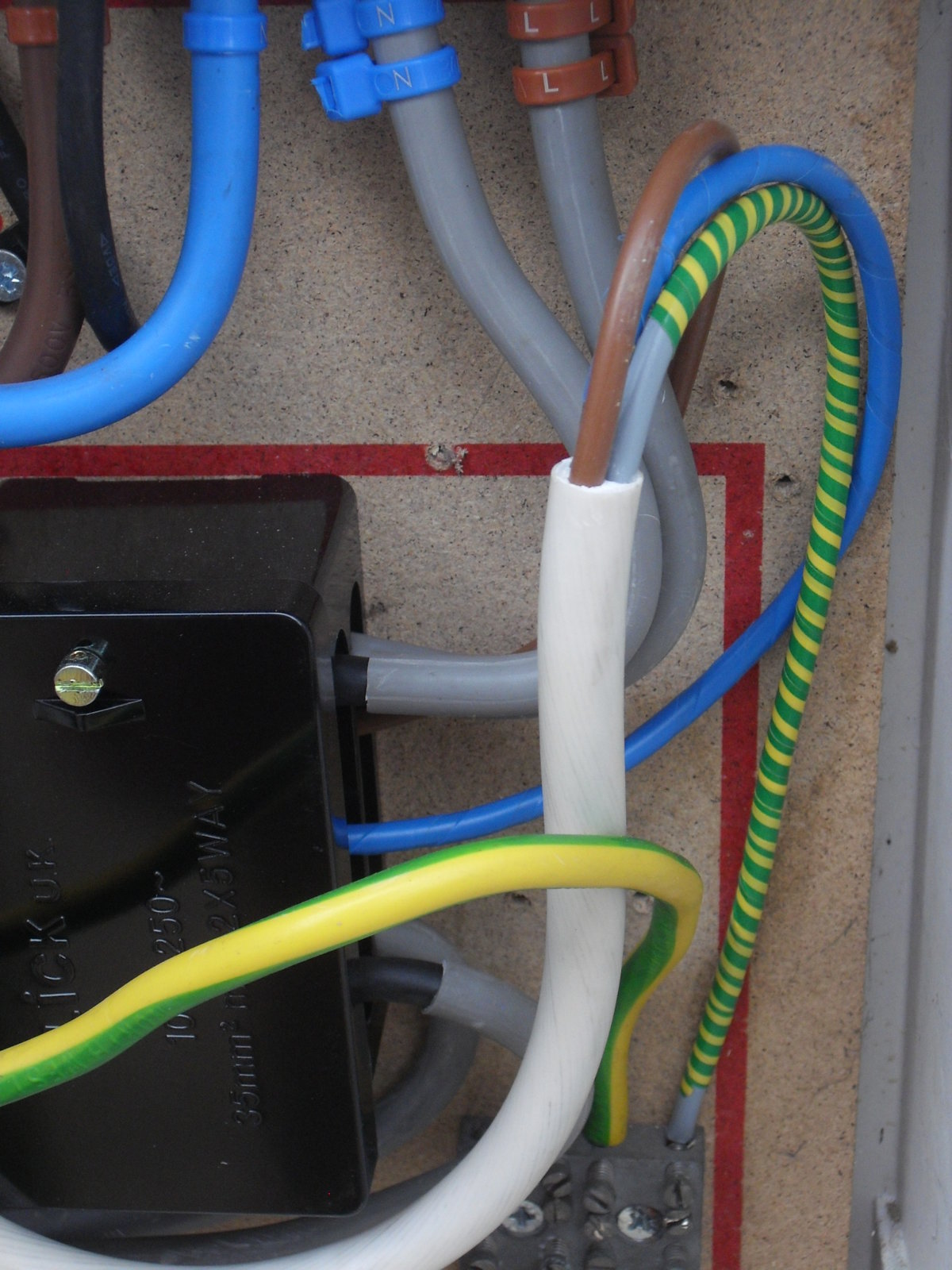

Noticed this today, newish db install supplied with paralleled 10mm2 singles. Moeller unit with only one Moeller device, no blanks. The outgoing cables were just tied to nearby pipes and cables, or just left hanging. Looking at the small earth block, it is likely strands were cut out to make the earth conductors fit, they have very small terminal holes. There is 2 large AC units, 4X 3KW water heaters, 2x 8.5KW showers, a ring final and a lighting circuit connected here.
Cable and wall look unsightly?
No worries just cover it with some trellis and it’ll be right...

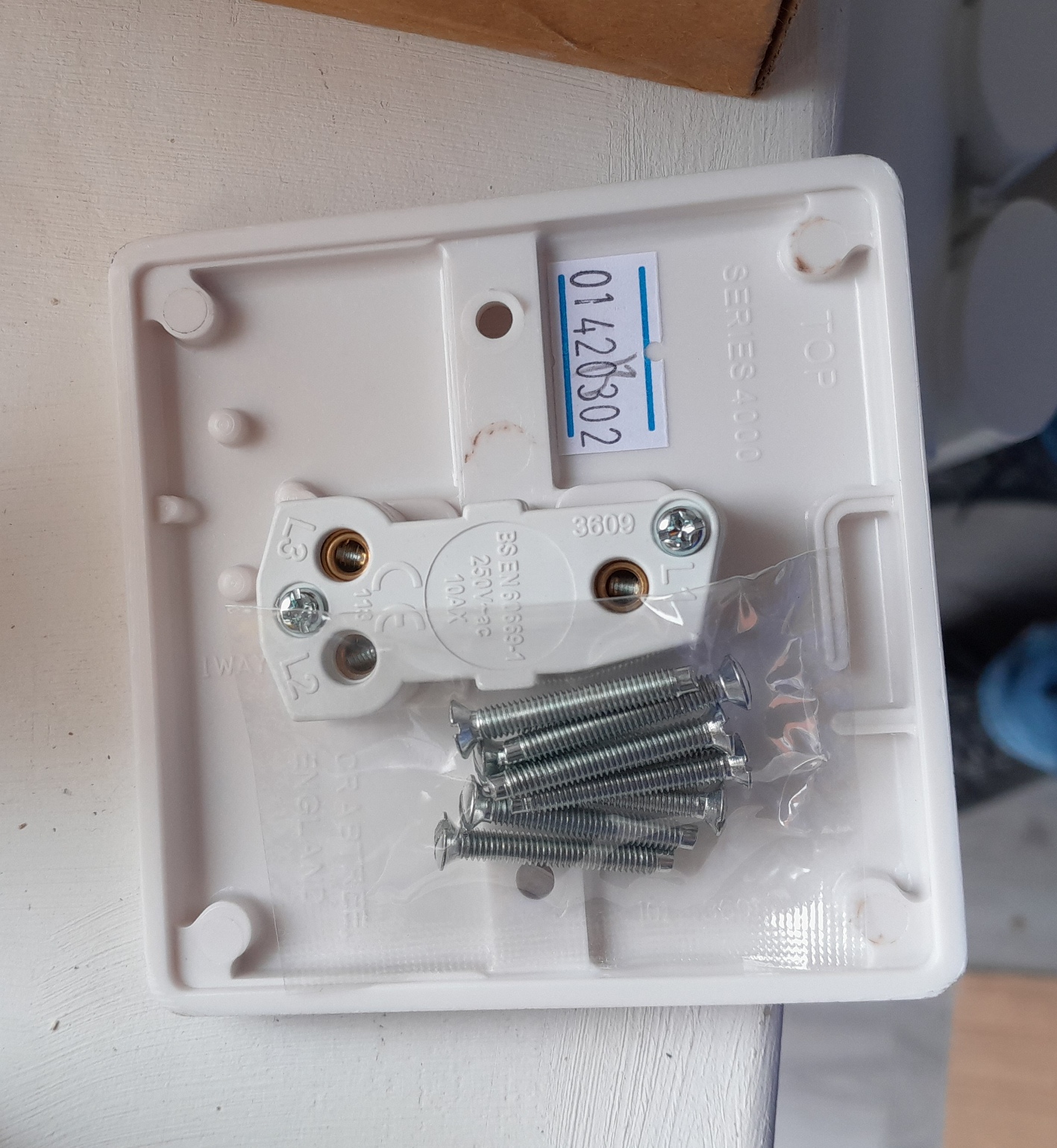

Working on a 1950s semi. Did have a dual RCD board. Upstairs and downstairs lighting circuits. Upgraded to an RCBO board and individually the lighting circuits started tripping. This is the two gang switch on the landing which is two way with switches on the ground floor controlling hall and landing lights.
