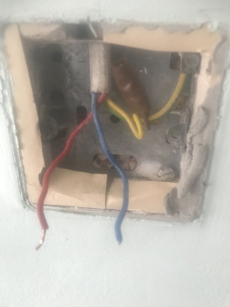

Less dodgy, more just stupidity courtesy of one of our “multi-skilled” technicians. Bear in mind the multi-skilled guy has an electrician to guide them on their shift and they supposedly checked all this together!
Yesterday a cooling fan wasn’t working, they went to it and reported back at shift change when we started that the contactor needed replacing because it wasn’t coming in. We asked if they checked the voltage at the coil “yeah, 230” was the answer.
I suspect not somehow, but at least we know why it isn’t coming in...
The machine wasn’t needed until this afternoon so we left it for them to wire up the coil this morning, and hopefully learn something in the process.
They wired the coil into a nearby transformer in the machine. We got called back just after shift change for cooling fan not working and “smell of burning”. That’ll be 230 through the 110 coil then.
In fairness the almost identical machine next to it was wired the same way, just went into a 230v coil.

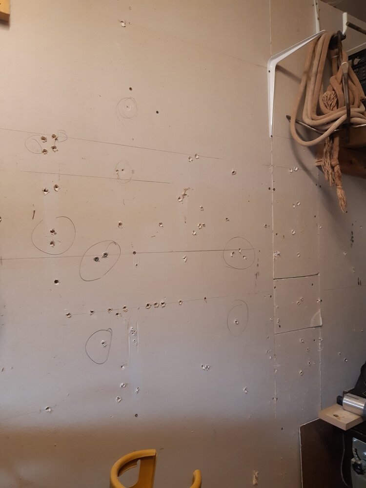

Got called out because customer couldn't reset RCD after attempting to put up shelving.
6 months earlier I was called to the same fault at the same house.
Scatter bombs approach,
Drill enough holes and your bound to get one eventually.
Maybe the home owner just liked your smile?
