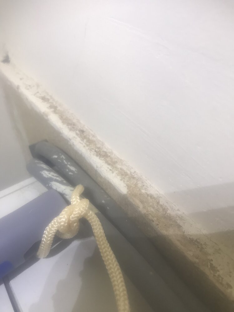

Mine was an old cooker hood I took down. Supply had been taken diagonally from a socket above worktop.
Whoever put the old hood up managed to drill through the cpc of a t&e... the rawl plug acted as an isolator between the L and N which hadn’t been cut.
Hood worked, just never been earthed.
classic. i had one the other week, rawlplug and screw through L courtesy of kevin. screw was live, so he stuck some tape over the screw head and told customer it;s safe now. FFS.
It’s amazing the amount of times someone manages to put a screw / nail through a buried cable breaking the cpc and only just scraping the live and neutral Cores...
Failing to trip the mcb & leaving the cable live but without an earth beyond the hole.
perhaps buried cables should be of screened type so the cpc is fully around the inner cores..
True. The above one is the same. But, in this case, with such a small pin shorting L and N....and the earth having no insulation, it tends to take the majority of the blast.
