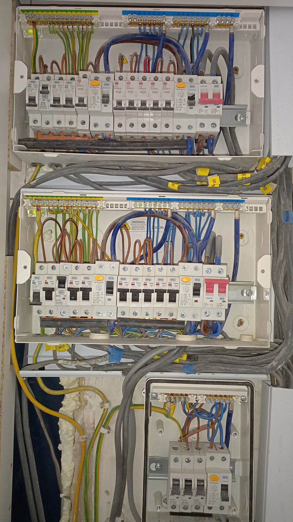

New consumer unit (sorry, units) for a small 2-bedroom flat.
I particularly like the way the busbar in the top right group of circuits has been bent in a zig-zag to accomodate the 3 different brands of MCB, especially noticable for the Wylex MCB.
There are several MCBs supplying individual outlets - e.g. the cooker hood is one circuit, the shaver socket is one circuit. So many circuits that a third lower garage CU was needed as an extra when all the initial 20 ways were used up.
But then all the internal lights are on one circuit, even though there are two outgoing feeds from the MCB.
If you look closely, you'll see there are only 2.5mm2 and 1.5mm2 outgoing cables. Even though there are two cooker circuits, one supplying a 7.5kW hob.
At least some care has been taken over getting all the N and E wires dead straight in the main units.

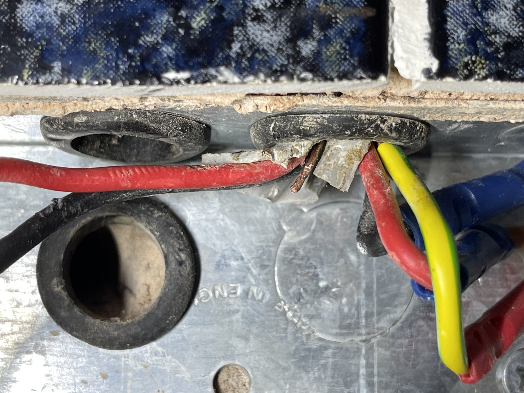

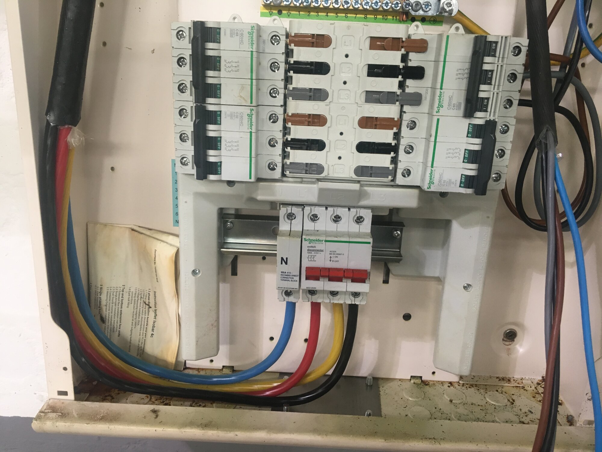

This morning’s find when installing a machine from existing board.
took me a moment to process why my eyes were arguing with my brain!
edit.
the blue is actually a N so I presume the same person has connected both ends.
edit.
WTF? I can only assume it is someone totally ignorant of the old colours improvising instead of asking or looking it up. But such a person has no bloody business working on that sort of system!
What should have been a simple job is going to be a lot more involved.
Tiled walls and the CPC of one leg of the ring is broken in the kitchen in such a way that it can’t be fixed easily. Oh and the whole house is on one ring.

I do like a challenge. Was supposed to be a straightforward EICR 😂
Plan is to remove the back box and try and crimp a new bit of CPC to it. But if not I’ve told the client they will need the tiles etc removing and the cabinet as will need to chase out part of the wall.
It’s either that or rip up their oak flooring in the bedroom upstairs.
I know which option my money is on. 🤔🤪
Could you cut out another backbox above it, so they have a 2-up & 2-down pair of sockets? Might free enough cable for properly joining it all up, minimum tile damage, and extra sockets!
Everyone needs extra sockets!
Not really. It’s underneath a wall cabinet in the kitchen.
But I’ll suggest it to them as an option that will be cheaper than damaging the floor upstairs. 😂
