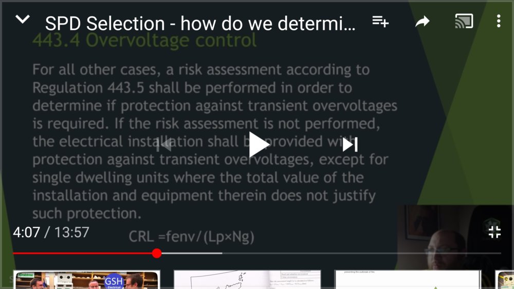

View: https://www.youtube.com/watch?v=DnEG8jhOHBw
does look a good charger. Do you have to be trained by the manufacturer to fit them?
guy in video, has no single point of isolation for the installation Now. The earth & blue sleeving used was rather large, no spd? But dont know when it was filmed..
