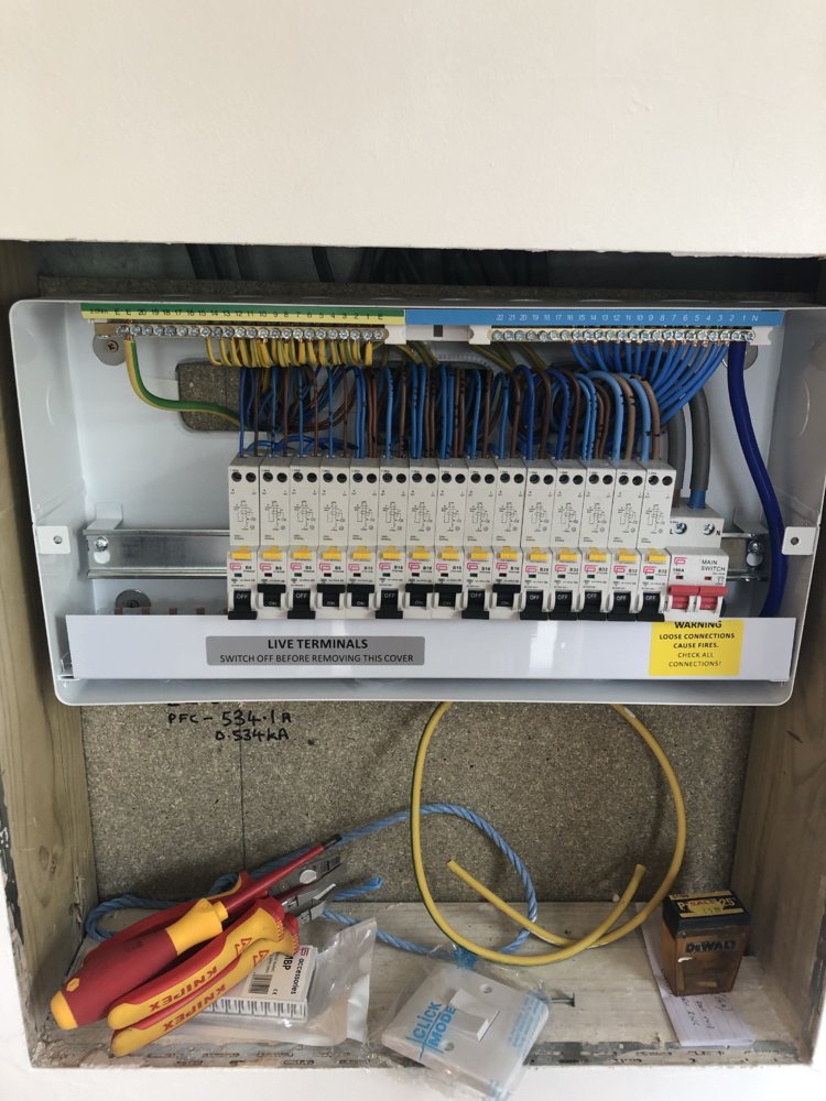

Has anyone used the brand Fusebox before, how do people rate it as I’m just looking at there main switch spd board with RCBOs
We always use Hager! But just shopping around...
Yes, I've installed several of the all-RCBO boards including the SPD, from the 6 way to the 20 way versions.
One of the main criteria was a reasonable cost RCBO, and no trailing earth leads from the RCBOs to make the board look like a bowl of spaghetti.
I've fitted quite a few too, I'd say they're very good value and decent quality.
Here's one I did a couple of months ago.

Another vote for Fusebox here, used quite a few of them in past 4 to 5 months, decent quality overall, and the price is extremely keen compared to Hager, like how the SPD comes with its own wires or connected in some boards. Whereas any others I've used you need to add your own wiring to connect them.

Just seen them for the first time here in century electrical this morning as its somewhere I dont usually go. Would you say it's worth giving them a go then?
DSS electrical on the tube is now saying they are the worst boards he's ever fitted. Worse than BG - that takes some beating!
Have to say I've been looking at them though given the price. Been given good prices by YESSS
Have you a link to the video?
I have fitted loads of BG before and would personally rate the Fusebox a shed load better than BG, I really can't justify paying double the price for an Rcbo and SPD just because it says Hager on it. I'd rather have the price difference in my bank account than Hagers lol
