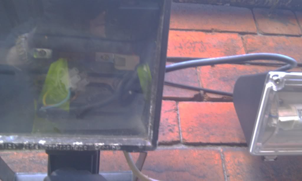

This was my favourite to date. it was a house of horrors, DIY EVERYWHERE, with end to end readings being far too low for the size of the house on down ring. low IR's all over the place on 4-5 of the circuits. after tracing cables all over the house i discovered this (to be fair to whoever had done it, before i took this photo the junction box (without lid) was insulated.................. with a carrier bag!)

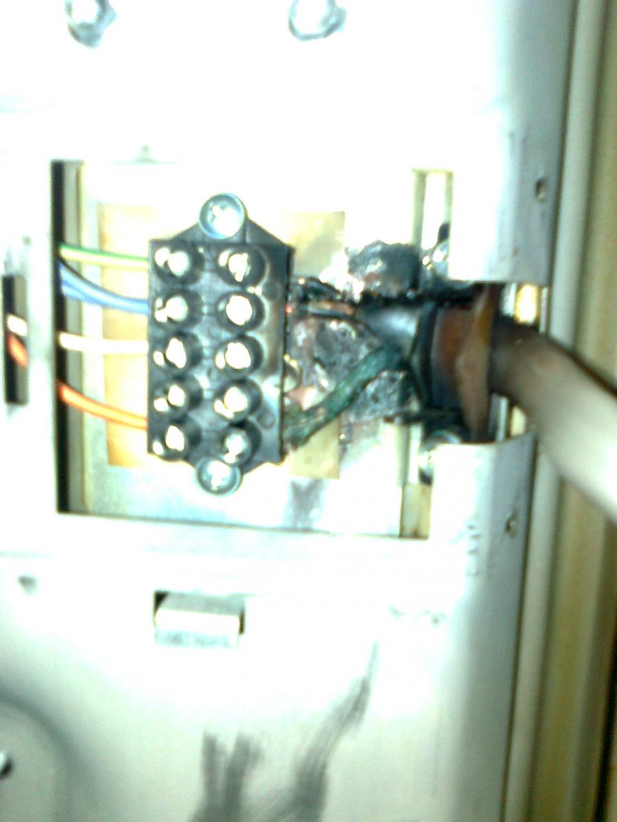

This is the fault I traced following a kitchen installation by a general kitchen fitter.......[ElectriciansForums.net] Hall of Shame Photos[ElectriciansForums.net] Hall of Shame Photos[ElectriciansForums.net] Hall of Shame Photos[ElectriciansForums.net] Hall of Shame Photos
luckily i had a cable tracer on me that day and the house had an RCD, even one for
the whole house. Guy had told the customer that it would stop tripping out when
the wall dried out !!!!
Then I looked at the connection behind the cooker...........

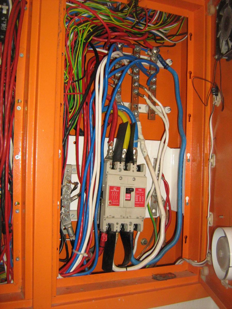

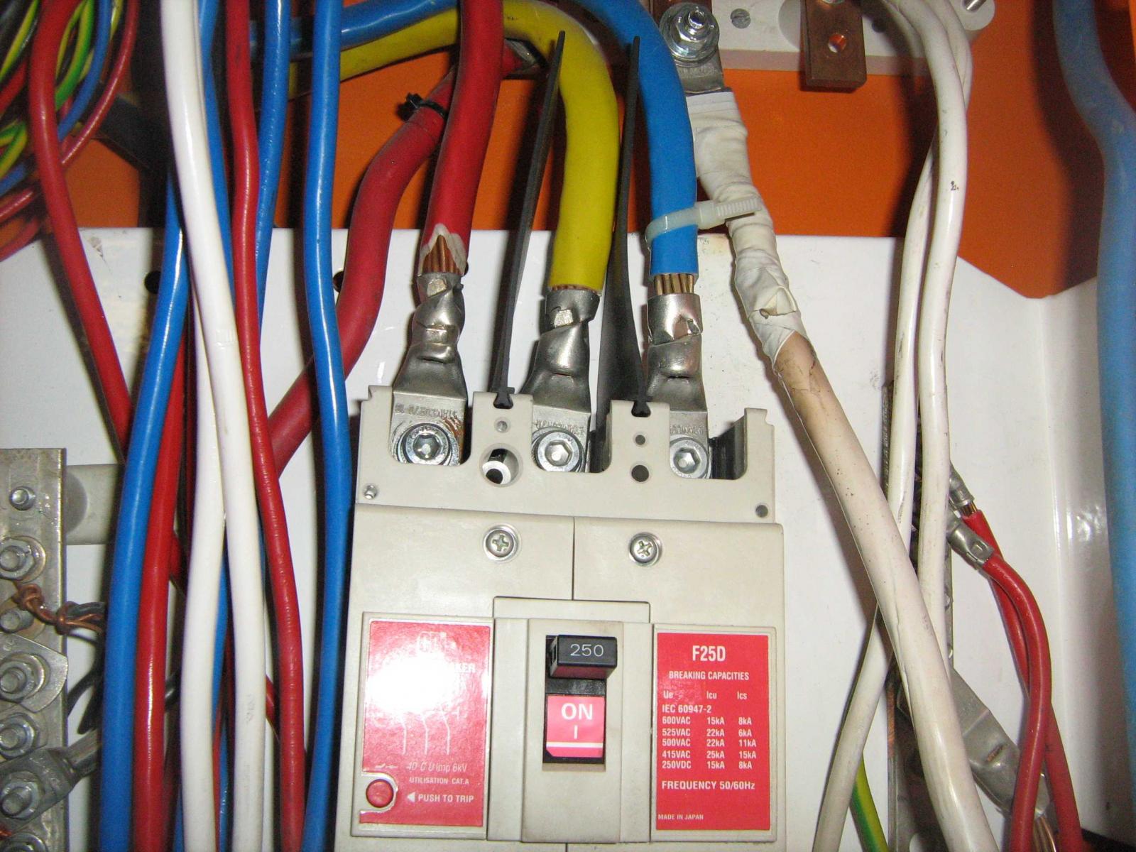

YIKES!!! Full use made of this henley block! Some circuits wired directly from it with no circuit protection. Wrong colours used for some meter tails, missing cpcs all over the place - the list is endless - fortunately it'll be a full rewire.
