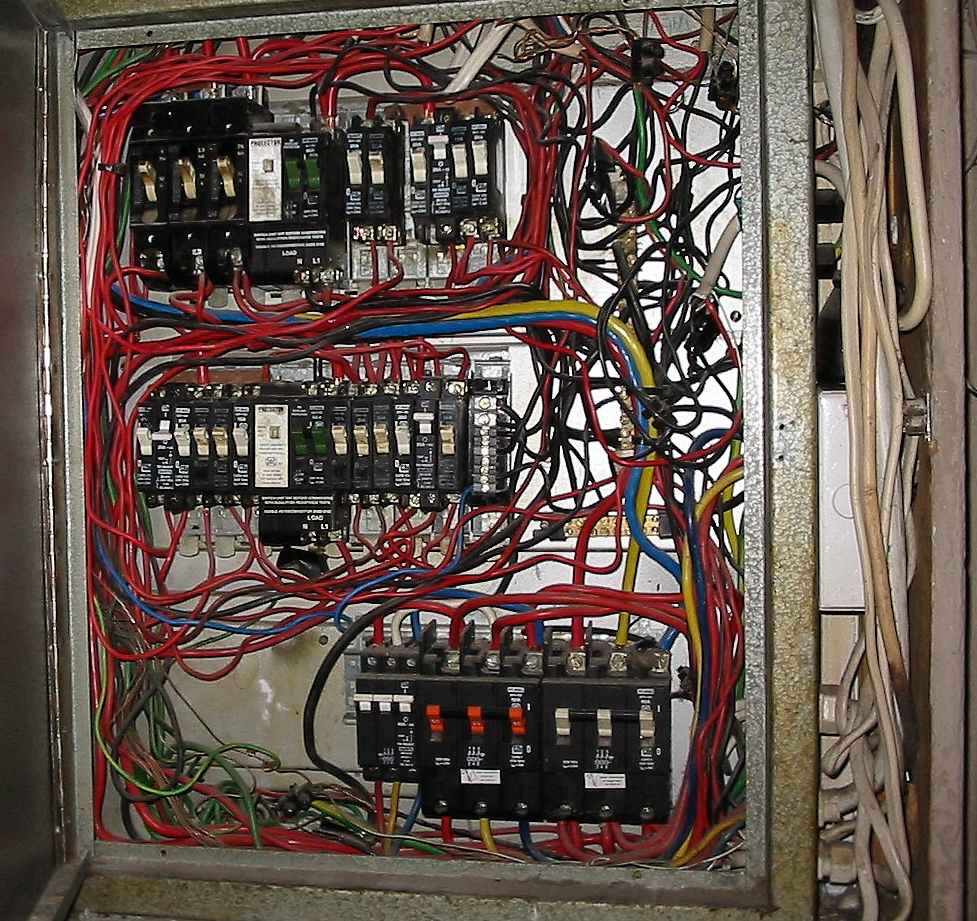

Well it's about time I show you guys how it's done in Africa. Here's an installation I got called to today by the building management company. There's been a recent history of BMS fire alarm episodes where stairwell pressurisation fans for the block of flats above this retail premises has been causing an annoyance. This was the DB for the retail premises.
The DB main breaker looks like it was installed by a complete imbecile who had nothing in his toolbox apart from a hammer and chisel. After speaking to the tenant it turns out that the breaker has had a history of tripping for 'no apparent reason' over the last few months.
Now that's what you call crimping!! lol!! Nice cable dressing, excellent safe distribution system of the phases and neutral... what you complaining about Marvo?? lol!!:p

I've also got some classic pictures of the rest of the DB if anyone's actually interested. Don't worry I completely understand if you've seen enough already.

If I hadn’t got the correct crimper, I’d have got the gas torch out and sweated the lugs. What the hell did he use?

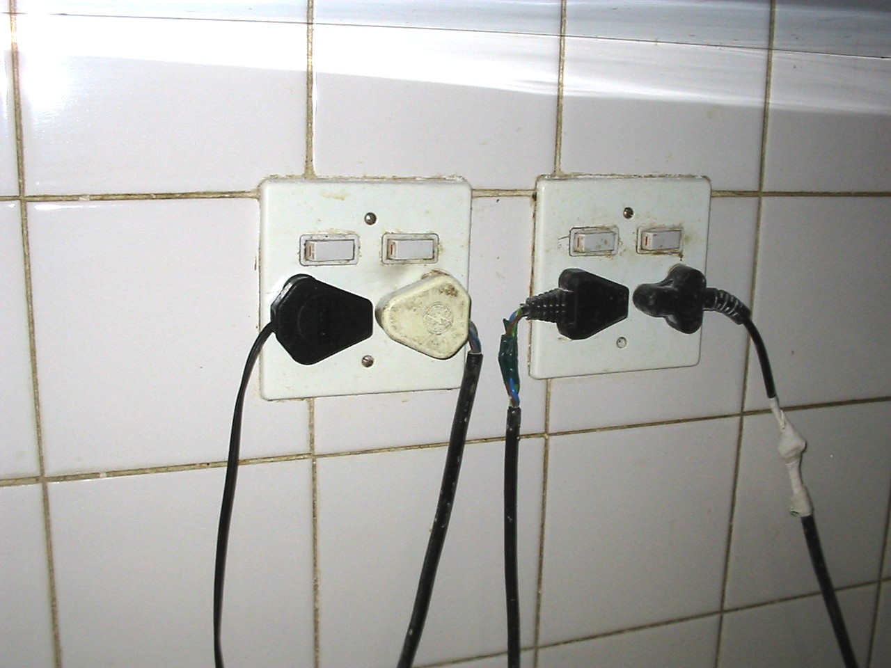

I must say i really like these picture even i wunt do this stuff and im not even fully qualified haha and I always thought that the building regs say that a socket has to be at least 500mm away from a sink
