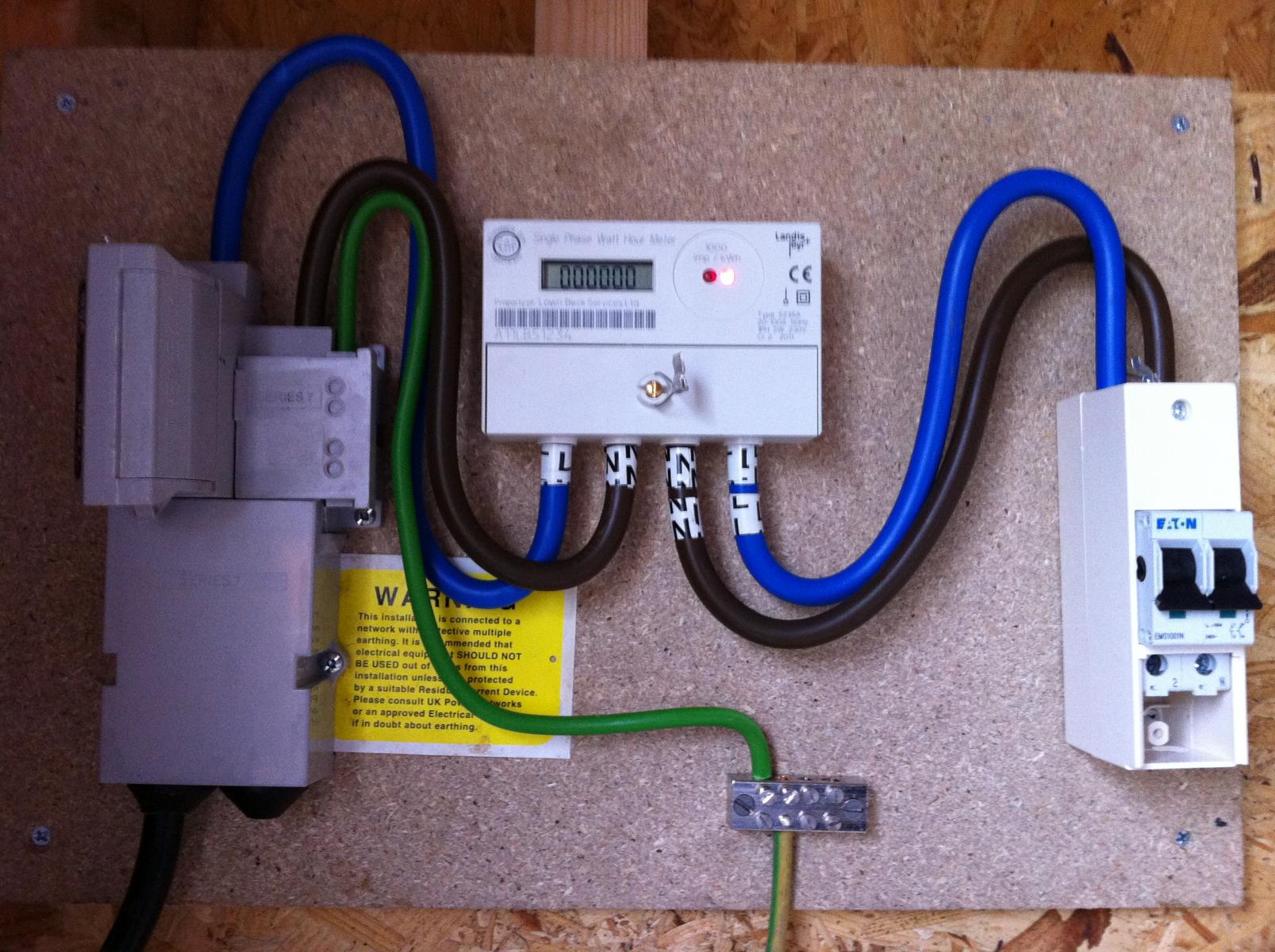

Any idea of age?
[ElectriciansForums.net] Hall of Shame Photos
Yes, noticed that. Lots of discussion about that kind of thing - asked NICEIC inspector about it on last assessment - he said leave it alone. Asked him about requesting change to PME to overcome the problem - he reckoned TNS with 951 clamp and acceptable Ze is always preferable to PME. Who am I to disagree?
As far as I'm aware/concerned, that end of the earthing conductor is outside of our responsibility.

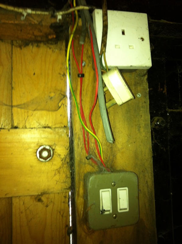

buried in a wall behind some tiles..... nice!
what is that behind them green latex gloves? (i think the gloves are meant to act as insulation) oh dear!
oh its a ring main connector blocked together with a spur off to a double socket.
Found this buried in the wall (it's for a boiler supply)

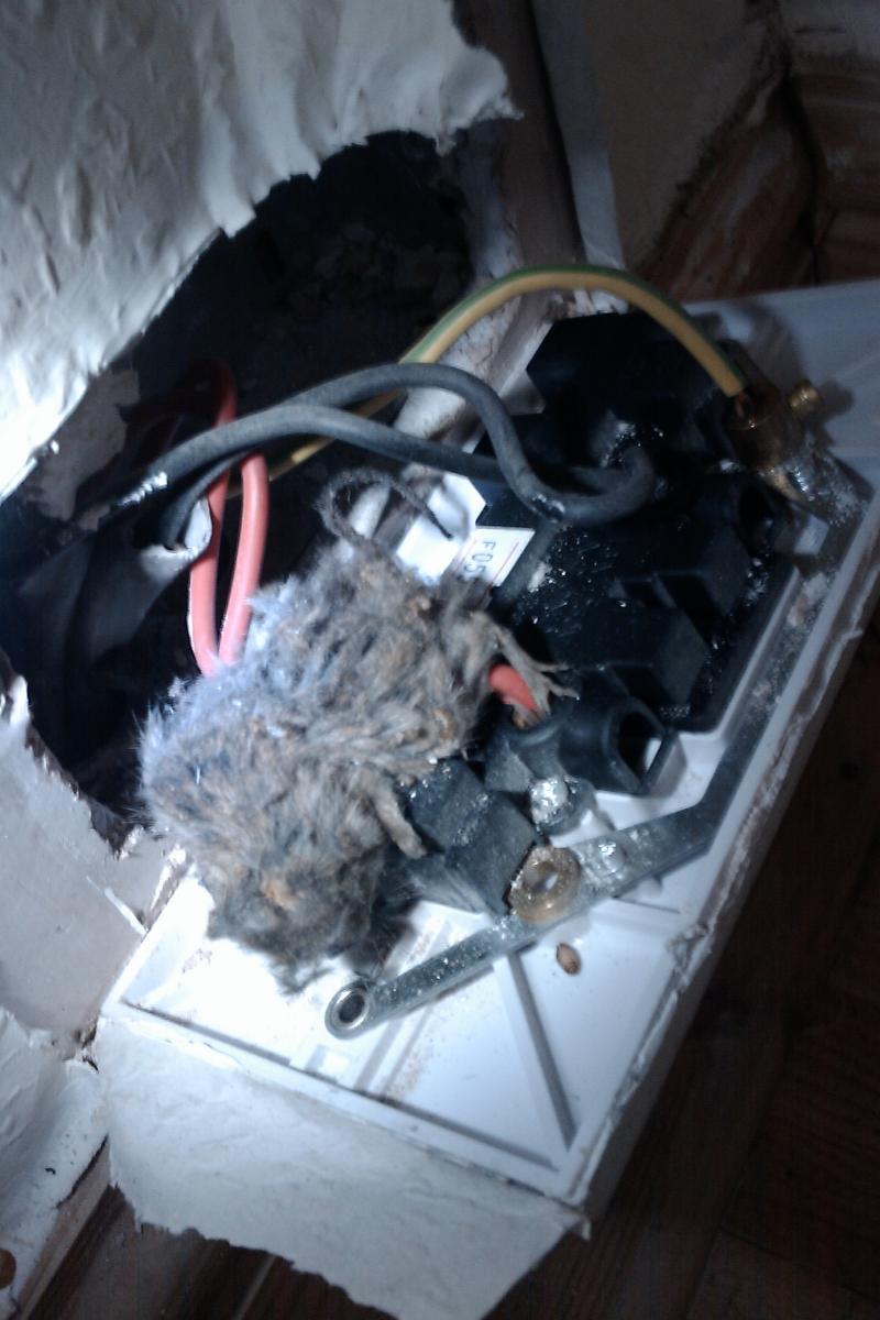

Changed a cooker for a client, this is what I found behind the connector plate. The lady of the house wired it 5yrs previously
Brown tape for the earth
Cut pieces of pvc insulation to cover the over stripped inner insulation
Twist the earth back together as it's a bit too short!

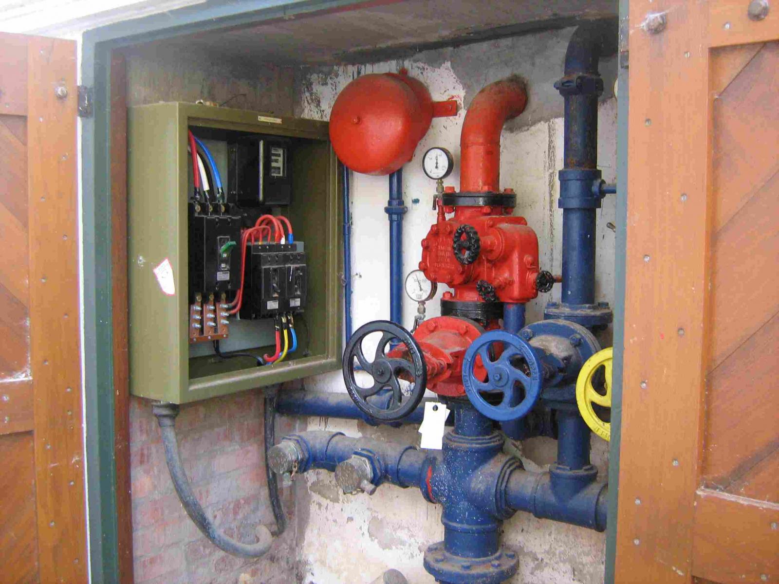

Well it's about time I show you guys how it's done in Africa. Here's an installation I got called to today by the building management company. There's been a recent history of BMS fire alarm episodes where stairwell pressurisation fans for the block of flats above this retail premises has been causing an annoyance. This was the DB for the retail premises.
The DB main breaker looks like it was installed by a complete imbecile who had nothing in his toolbox apart from a hammer and chisel. After speaking to the tenant it turns out that the breaker has had a history of tripping for 'no apparent reason' over the last few months.
As if this world class installation wasn't enough the electrician has been back a few times and eventually remedied the problem with these;
As an added bonus in the second photo you'll get a chance to check out his VFD wiring job.
